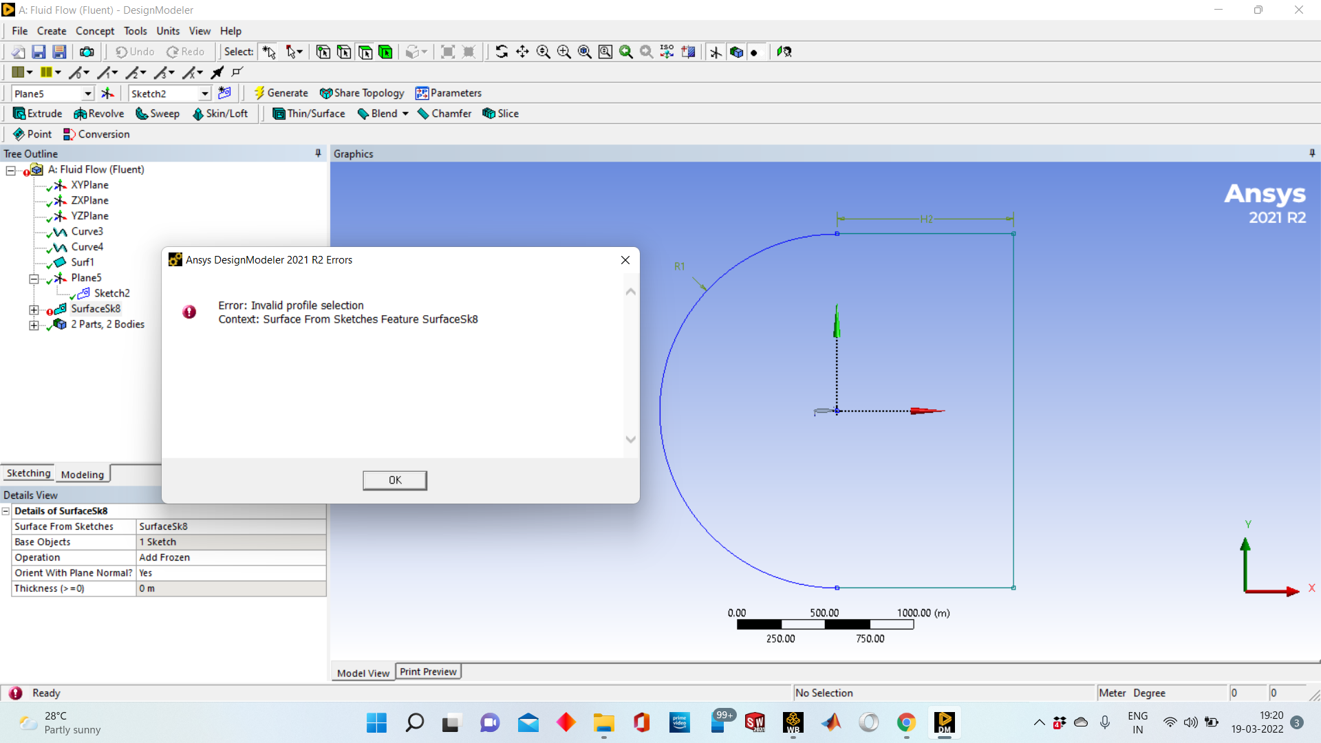

SubscriberI don't understand why is it showing as like this even after crosschecking the sketches.
March 21, 2022 at 4:29 amKeyur Kanade
Ansys EmployeePlease zoon in sketch. It may not be forming closed loop. It must have open end.
Regards Keyur
