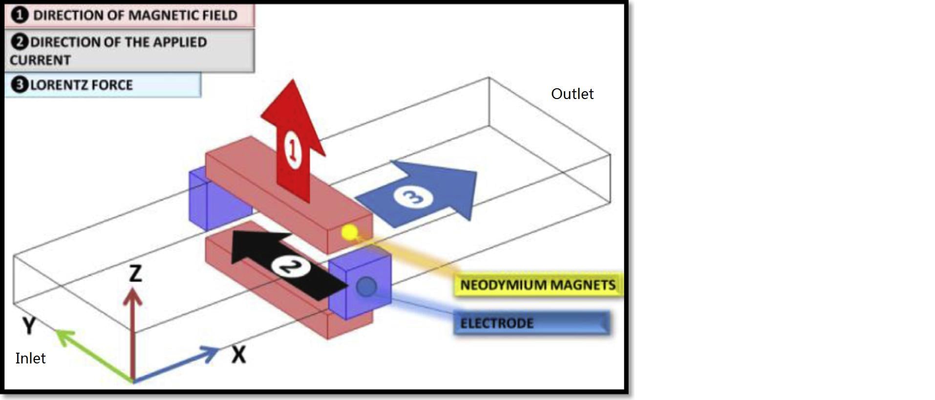

    • kzqing
      I am trying to model an electromagnetic pump. The model setup is like the following figure (just a rectangular channel). The fluid material is liquid lithium. I used electric potential MHD method in Fluent. The external magnetic field B0 is 0.7T at Z direction. The inlet is zero total pressure, outlet is zero static pressure. The left side wall has an electric potential of 0V, the right wall has an electric potential of 0.08V. The top and bottom walls are insulated.
      I tried to use these setup to run the simulation, but I just can't get a converged result, the intermediate result looks strange. I was wondering if my boundary conditions are correct. If someone can give me some guidelines. I will appreciate it. Thanks,
    • Konstantin
      My suggestions are:
      1) solve for the electric potential only by turning off flow equations, and verify if computed potential, current and Lorentz force are what you expect
      2) solve for the flow without MHD as a sanity check
      3) Lithium is quite conductive, and Lorentz force sources in the momentum equations will be large, which can impact convergence. You can try body force weighted scheme for pressure, P-V coupled, under-relax pressure and momentum to 0.2, and use Flow Courant Number of 20
