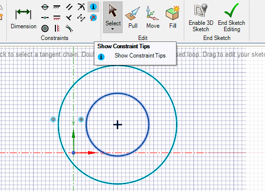

Sketching has some new features, too, and tracking is kind of blurring the line between direct modeling and feature modeling. One thing I really miss is an option to show constraint conditions in a sketch. Showing them only when touched is not enough.

October 16, 2019 at 10:49 am
October 16, 2019 at 4:23 pm
martin.kopplow
SubscriberThank you Naresh, I see now. They are so unrecognizeably small ob my screen*, though, so I did not identify them as symbols, just tiny blueish dots ... in which - looking real close - are in fact kind of symbols, but they are brown or grey on blue, which blurs it the more. They need to be bigger, and more contrasting.
Constraint sketching does only work when no second drawing window is open at any one time, so I cannot use it for prodictive work yet, anyway. It would be welcome, though.
Best, Martin
*(2x24"@1920x1200 using 120% zoom)
October 23, 2019 at 10:39 am
Naresh Patre
Ansys EmployeeHi Martin Kopplow
I agree that the constraints are difficult to recognize. I will pass on your suggestions to the development team for improving their visibility.
