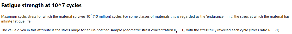

      And you can find fatigue strength data in Ansys Granta EduPack or Ansys Granta Selector for different PVCs, but I can't find any S-N curves sorry.
