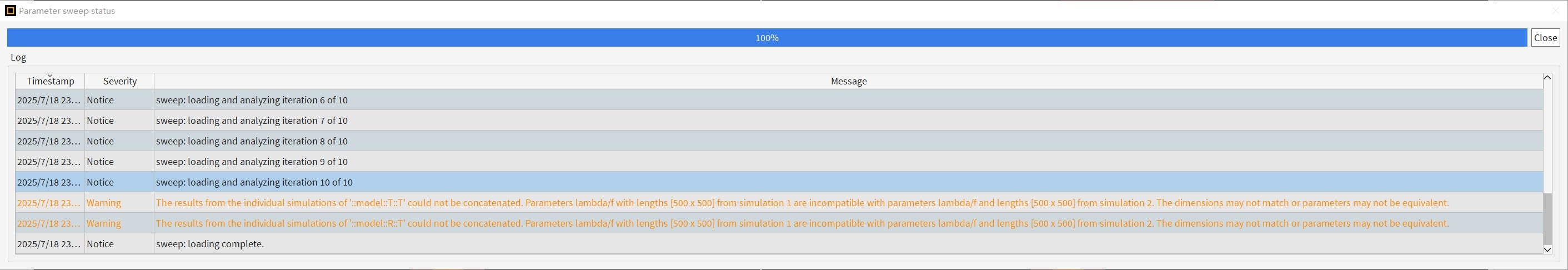

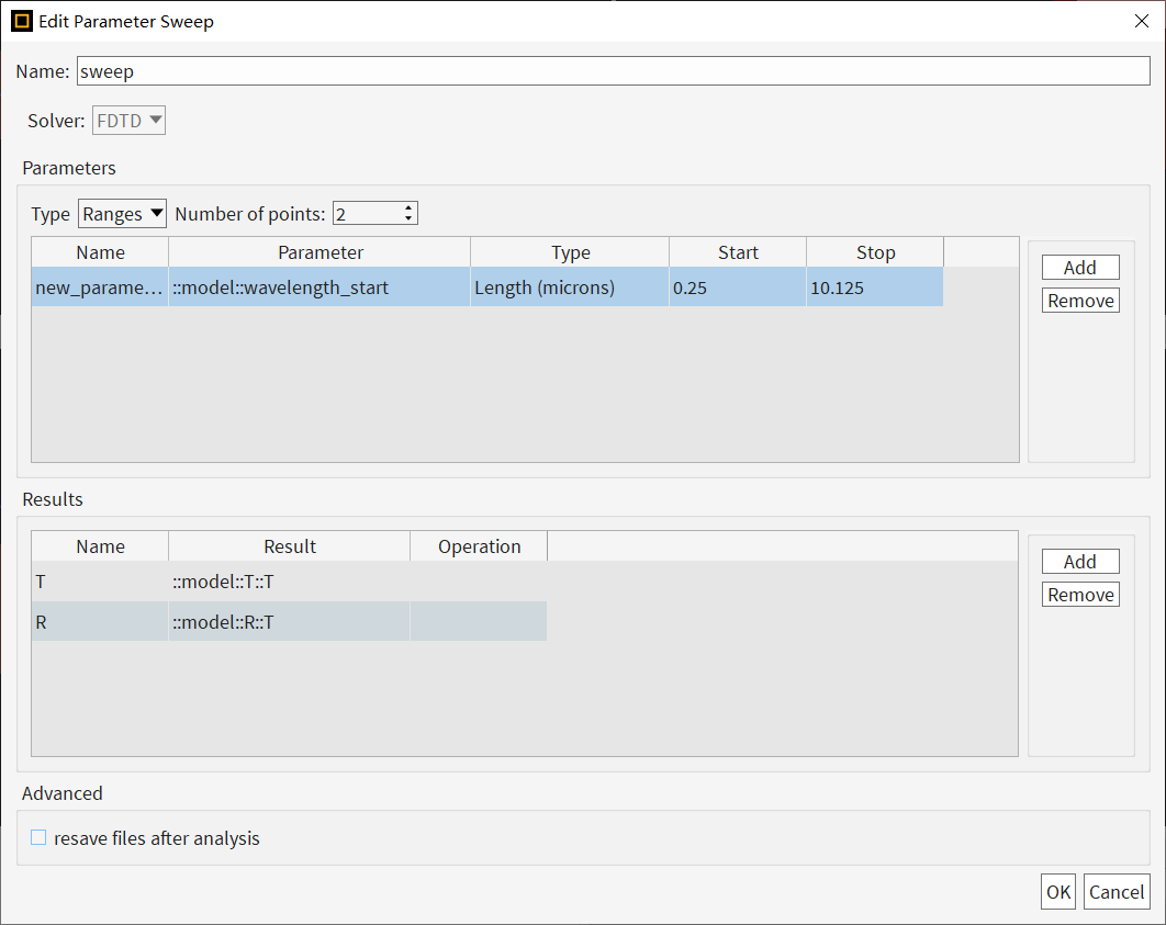

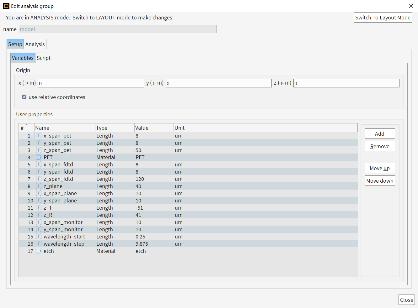

SubscriberI built this model to observe the transmission (T) and reflection (R) of light through the material from 0.25μm to 20μm. In previous attempts, setting the plane wave source directly to 0.25μm-20μm resulted in significant discrepancies from experimental results. Therefore, I'm attempting to split this wavelength range into multiple segments for simulation, as shown in the parameter sweep settings in the figure. However, no matter how I adjust the parameters—including creating a mesh override to cover the entire range—the simulation still fails to concatenate the results. I would greatly appreciate any guidance or solutions.
