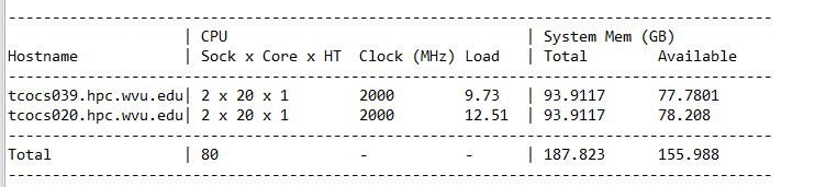

SubscriberThank you Kanade and Rob. The module I use is module load ansys/fluids_19.2. So the version is R19.2.nWhen I can't read it in 40 cores, somehow I can read dat.gz file with 6GB in 80 cores. But I can't request more CPU resource; 40 cores to run two weeks is my quota. Now I have to run the case day by day in order to request 80 cores. nThe case has run on HPC, and files are saved on HPC; I think it is local drive.nSince I doing coal combustion with DPM model, the number of particles at flow time 1.6 s is about 15 million. each time step, 9400 particles are injected into the burner. it is one of the reasons that file size keeps growing.April 20, 2021 at 2:41 pmRob
Forum ModeratorI wonder if you've run out of RAM, how much RAM is available per core? If you write out unzipped you can sometimes reduce the RAM need, but finish up with very big files. nApril 20, 2021 at 6:16 pmApril 20, 2021 at 8:38 pmlei2019

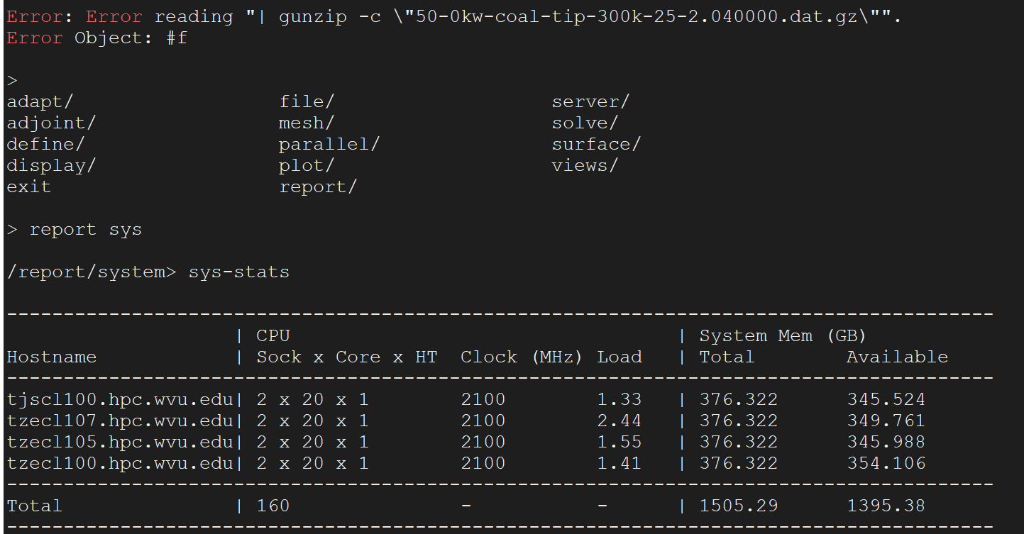

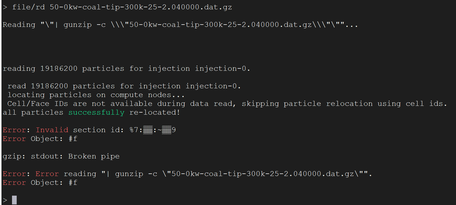

Subscribernnreading 19186200 particles for injection injection-0.nnFluent host process is out of memory (dpm/dpm.c:10025 9362865600 bytes).nn==============================================================================Node 0: Process 309147: Received signal SIGSEGV.nn==============================================================================nn==============================================================================Node 999999: Process 305767: Received signal SIGSEGV.nn==============================================================================nn===============Message from the Cortex Process================================nnFatal error in one of the compute processes.nn==============================================================================n*** Error in `/shared/software/ansys/v192/fluent/fluent19.2.0/lnamd64/3d_node/fluent_mpi.19.2.0': free(): corrupted unsorted chunks: 0x0000000005f52680 ***n*** Error in `/shared/software/ansys/v192/fluent/fluent19.2.0/lnamd64/3d_node/fluent_mpi.19.2.0': free(): corrupted unsorted chunks: 0x00000000067f1680 ***n*** Error in `/shared/software/ansys/v192/fluent/fluent19.2.0/lnamd64/3d_node/fluent_mpi.19.2.0': free(): corrupted unsorted chunks: 0x00000000059e6680 ***n======= Backtrace: =========n======= Backtrace: =========n/usr/lib64/libc.so.6(+0x81489)[0x7f7f248f0489]n/shared/software/ansys/v192/fluent/fluent19.2.0/multiport/mpi/lnamd64/ibmmpi/lib/linux_amd64/libmpi.so.1(free+0x2e)[0x7f7f2466fece]n/shared/software/ansys/v192/fluent/../commonfiles/CPython/2_7_13/linx64/Release/python/lib/libpython2.7.so.1.0(+0x8a7bd)[0x/shared/software/ansys/v192/fluent/../commonfiles/CPython/2_7_13/linx64/Release/python/lib/libpython2.7.so.1.0(+0x8a7bd)[0x7f7f258367bd]n/shared/software/ansys/v192/fluent/../commonfiles/CPython/2_7_13/linx64/Release/python/lib/libpython2.7.so.1.0(+0x9ca27)[0x7fdbe8500a27]n/shared/software/ansys/v192/fluent/../commonfiles/CPython/2_7_13/linx64/Release/python/lib/libpython2.7.so.1.0(+0x9ca27)[0x7f7f25848a27]n/shared/software/ansys/v192/fluent/../commonfiles/CPython/2_7_13/linx64/Release/python/lib/libpython2.7.so.1.0(PyDict_SetItem+0x67)[0x7fdbe8502487]n/shared/software/ansys/v192/fluent/../commonfiles/CPython/2_7_13/linx64/Release/python/lib/libpython2.7.so.1.0(PyDict_SetItemString+0x38)[0x7f50fb7d9b18]n/shared/software/ansys/v192/fluent/../commonfiles/CPython/2_7_13/linx64/Release/python/lib/libpython2.7.so.1.0(PyDict_SetItemString+0x38)[0x7f7f2584bb18]n/shared/software/ansys/v192/fluent/../commonfiles/CPython/2_7_13/linx64/Release/python/lib/libpython2.7.so.1.0(PyImport_Cleanup+0x127)[0x7fdbe8587767]n/shared/software/ansys/v192/fluent/../commonfiles/CPython/2_7_13/linx64/Release/python/lib/libpython2.7.so.1.0(PyImport_Cleanup+0x127)[0x7f7f258cf767]n/shared/software/ansys/v192/fluent/../commonfiles/CPython/2_7_13/linx64/Release/python/lib/libpython2.7.so.1.0(Py_Finalize+0xfe)[0x7fdbe85998de]n/shared/software/ansys/v192/fluent/../commonfiles/CPython/2_7_13/linx64/Release/python/lib/libpython2.7.so.1.0(Py_Finalize+0xfe)[0x7f7f258e18de]nnn
April 20, 2021 at 10:53 pmlei2019
Subscribertcocs018.hpc.wvu.edu-14869.shnsched_setaffinity() call failed: Invalid argumentnsched_setaffinity() call failed: Invalid argumentnsched_setaffinity() call failed: Invalid argumentnsched_setaffinity() call failed: Invalid argumentnsched_setaffinity() call failed: Invalid argumentnnError: Invalid section id: %7:Ýøu000e:~Ïà9nError Object: #fnngzip: stdout: Broken pipennError: Error reading | gunzip -c 50-0kw-coal-tip-300k-25-2.040000.dat.gz.nError Object: #fnn==============================================================================nStack backtrace generated for process id 14709 on signal 11 :n1000000: fluent() [0x67f3b9]n1000000: /usr/lib64/libc.so.6(+0x36280) [0x7f2f9826c280]n1000000: /usr/lib64/libc.so.6(+0x39acd) [0x7f2f9826facd]n1000000: /usr/lib64/libc.so.6(+0x39bb7) [0x7f2f9826fbb7]n1000000: fluent(main+0x9c) [0x67f99c]n1000000: /usr/lib64/libc.so.6(__libc_start_main+0xf5) [0x7f2f982583d5]n1000000: fluent() [0x5ed4fd]nPlease include this information with any bug report you file on this issue!n==============================================================================nnApril 21, 2021 at 10:26 amYasserSelima
Subscriber360 GB should be enough , but they are distributed between all nodes evenly. When you have particle tracking, the host requires memory enough to store the entire mesh. I mean the host is now storing the 15 millions paths ... nApril 21, 2021 at 10:31 amYasserSelima
SubscriberNode 999999 is the host ... and it is Compute Node 0 as well. That is why you get the error at this nodenApril 21, 2021 at 2:24 pmlei2019
SubscriberSo the host node 0 (999999) storing 15 million paths alone? how to solve this issue? Thank you, Yassser nApril 21, 2021 at 2:44 pmlei2019

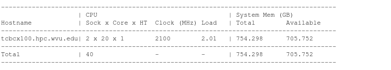

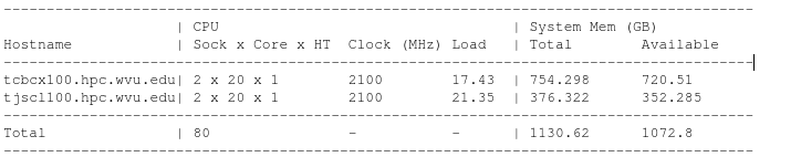

SubscriberUsing shared memory for DPM with 80 cores, 1000GB nFilling Host Domain 1 [38.7291 sec]Warning: new_object_mt: Unable to allocate objects. Out of memorynn==============================================================================Node 999999: Process 421484: Received signal SIGSEGV.nn==============================================================================nMPI Application rank 32 killed before MPI_Finalize() with signal 11nMPI Application rank 77 exited before MPI_Finalize() with status 2n*** Error in `/shared/software/ansys/v192/fluent/fluent19.2.0/lnamd64/3d_node/fluent_mpi.19.2.0': free(): corrupted unsorted chunks: 0x0000000006943f70 ***n*** Error in `/shared/software/ansys/v192/fluent/fluent19.2.0/lnamd64/3d_node/fluent_mpi.19.2.0': free(): corrupted unsorted chunks: 0x00000000063cef70 ***n*** Error in `/shared/software/ansys/v192/fluent/fluent19.2.0/lnamd64/3d_node/fluent_mpi.19.2.0': free(): corrupted unsorted chunks: 0x0000000005217f70 ***n======= Backtrace: =========n======= Backtrace: =========n======= Backtrace: =========n/usr/lib64/libc.so.6(+0x81489)[0x7fd43a1b1489]n/usr/lib64/libc.so.6(+0x81489)[0x7f9d1e724489]n/usr/lib64/libc.so.6(+0x81489)[0x7fa92226e489]n/shared/software/ansys/v192/fluent/fluent19.2.0/multiport/mpi/lnamd64/ibmmpi/lib/linux_amd64/libmpi.so.1(free+0x2e)[0x7f9d1e4a3ece]n/shared/software/ansys/v192/fluent/fluent19.2.0/multiport/mpi/lnamd64/ibmmpi/lib/linux_amd64/libmpi.so.1(free+0x2e)[0x7fd439f30ece]n/shared/software/ansys/v192/fluent/../commonfiles/CPython/2_7_13/linx64/Release/python/lib/libpython2.7.so.1.0(+0x8a7bd)[0x7fd43b0f77bd]n/shared/software/ansys/v192/fluent/../commonfiles/CPython/2_7_13/linx64/Release/python/lib/libpython2.7.so.1.0(+0x8a7bd)[0x7f9d1f66a7bd]n/shared/software/ansys/v192/fluent/fluent19.2.0/multiport/mpi/lnamd64/ibmmpi/lib/linux_amd64/libmpi.so.1(free+0x2e)[0x7fa921fedece]n/shared/software/ansys/v192/fluent/../commonfiles/CPython/2_7_13/linx64/Release/python/lib/libpython2.7.so.1.0(+0x9ca27)[0x7fd43b109a27]n/shared/software/ansys/v192/fluent/../commonfiles/CPython/2_7_13/linx64/Release/python/lib/libpython2.7.so.1.0(+0x9ca27)[0x7f9d1f67ca27]n
April 22, 2021 at 12:26 pmRob
Forum ModeratorCan the head node see all that RAM? nApril 22, 2021 at 1:41 pmApril 22, 2021 at 3:08 pmelectroknit
SubscriberArrayRob,n If I'm understanding correctly here, Head Node in this case means the node where the ansys process is started? In the above example from Lei, that is the node with 756GB RAM. I have tried a variety of methods, spreading out the job so that there would be (for example) a smaller number of processes so that each MPI process would have 300+GB of ram available to it, but with similar results.nApril 22, 2021 at 3:13 pmlei2019

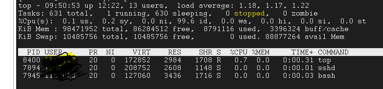

Subscriberby using pbsnodes -a | less |egrep 487198 at head node: nsome info about a case I am running now,nnn jobs = 0-39/487198.trcis002.hpc.wvu.edun status = opsys=linux,uname=Linux tcocs020.hpc.wvu.edu 3.10.0-957.el7.x86_64 #1 SMP Thu Oct 4 20:48:51 UTC 2018 x86_64,sessions=6008,nsessions=1,nusers=1,idletime=19231116,totmem=108959308kb,availmem=69232560kb,physmem=98473552kb,ncpus=40,loadave=43.75,gres=,netload=53571989872582,state=free,varattr= ,cpuclock=Fixed,macaddr=20:67:7c:57:47:d4,version=6.1.3,rectime=1619104148,jobs=487198.trcis002.hpc.wvu.edun jobs = 0-39/487198.trcis002.hpc.wvu.edun status = opsys=linux,uname=Linux tcocs039.hpc.wvu.edu 3.10.0-957.el7.x86_64 #1 SMP Thu Oct 4 20:48:51 UTC 2018 x86_64,sessions=28820,nsessions=1,nusers=1,idletime=12870432,totmem=108959308kb,availmem=66161132kb,physmem=98473552kb,ncpus=40,loadave=46.52,gres=,netload=17351822237817,state=free,varattr= ,cpuclock=Fixed,macaddr=20:67:7c:57:48:40,version=6.1.3,rectime=1619104139,jobs=487198.trcis002.hpc.wvu.edu
