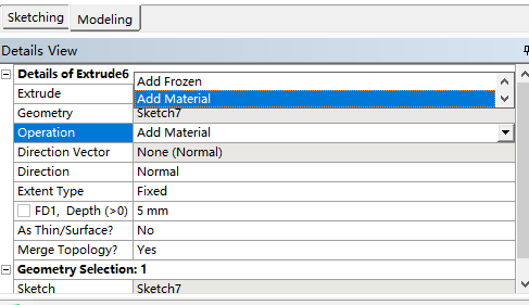

I'm a freshman,an i have a very simple quesion!
which option shloud i choose , when i want to extrude a solid body. And i not clear the difference and functions with the two options.
I'm working on Ansys 19.2
July 16, 2021 at 11:19 pmpeteroznewman
SubscriberAdd Material unites the new feature onto an existing base solid.
Add Frozen creates a new solid.
