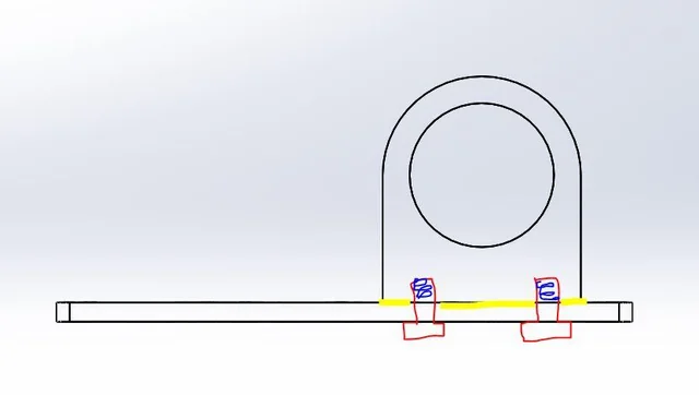

SubscriberThe real connection is frictional contact between the mount and plate with a bolt pretension on the fasteners, but Modal is a linear analysis so you can't have that behavior. There are two linear options that will have slightly different Modal frequencies.
- Bonded Contact between the base of the mount with an imprinted face on the plate (no bolts).
- Two Fixed Joints between the blind hole in the mount and an imprint of the bolt head (or washer) on the plate face (no contact at the yellow mount face).
 If you measured the modal frequency of the mount bending about the base, it would probably fall somewhere between these two models.
