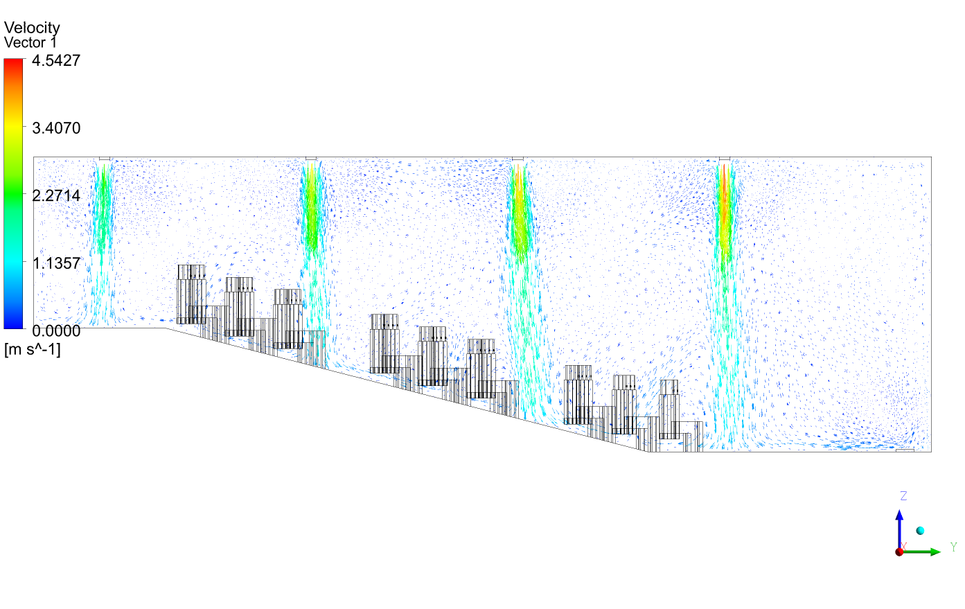

SubscriberHello everyone,ÂI am performing a CFD simulation of indoor airflow and COâ‚‚ distribution in a lecture hall using ANSYS Fluent with the Species Transport model (COâ‚‚ treated as a passive scalar).ÂI have some questions regarding how to correctly define COâ‚‚ sources and boundary conditions:ÂCOâ‚‚ from occupants (breathing):What is the recommended way to model COâ‚‚ exhalation from people?Should it be defined as:a mass source term (kg/s) in a small volume near the mouth, ora boundary condition (e.g., velocity inlet with specified COâ‚‚ mass fraction)?COâ‚‚ concentration at supply air diffusers:For the supply air, I set the COâ‚‚ concentration to 0.001283Â ( AHU set 28% outdoor air and 72% indoor air ,so 500 ppm, mass fraction = 0.000725 , 1000 ppm, mass fraction = 0.0015 , 0.000725*0.28 + 0.0015*0.72 = 0.001283 ).Is this the correct approach?COâ‚‚ setting at return outlets (pressure outlet):For return air outlets, should I define the backflow COâ‚‚ mass fraction as outdoor concentration (500 ppm), or should it be left unspecified?General modeling approach:Is it more appropriate to model COâ‚‚ as a volumetric source distributed in the occupied zone, or as localized sources at each occupant?ÂMy goal is to obtain realistic COâ‚‚ distribution and evaluate ventilation effectiveness in the breathing zone.ÂAny suggestions or best practices would be greatly appreciated. Thank you! -

Both options work, in that either a source or inlet can be used. However, unless you want to resolve to individual people it's more common to use a source term to add CO2, water vapour and heat into the "occupied space". That also avoids diffusion effects on boundaries.Â
For the supply/return air fraction, that's a boundary value so you need to decide what you're doing. What you can do is use Expressions to find the extract volume fraction and use a function of that for the inlet. Possibly overkill, and could be a little unstable in the early part of the model. You're also trying to model trace elements in the bulk flow. So, if your convergence isn't good (and it's buoyant flow so it won't be) your error could exceed the CO2 mass flux: what do you think a good solution could be?
I assume you're using incompressible ideal gas for the mixture density?Â

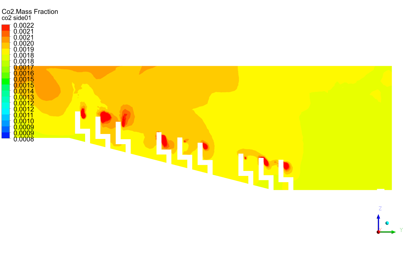

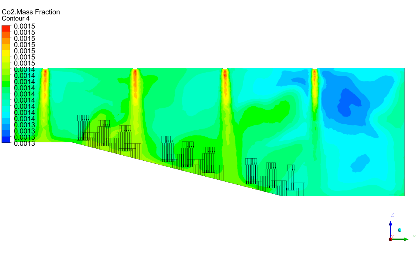

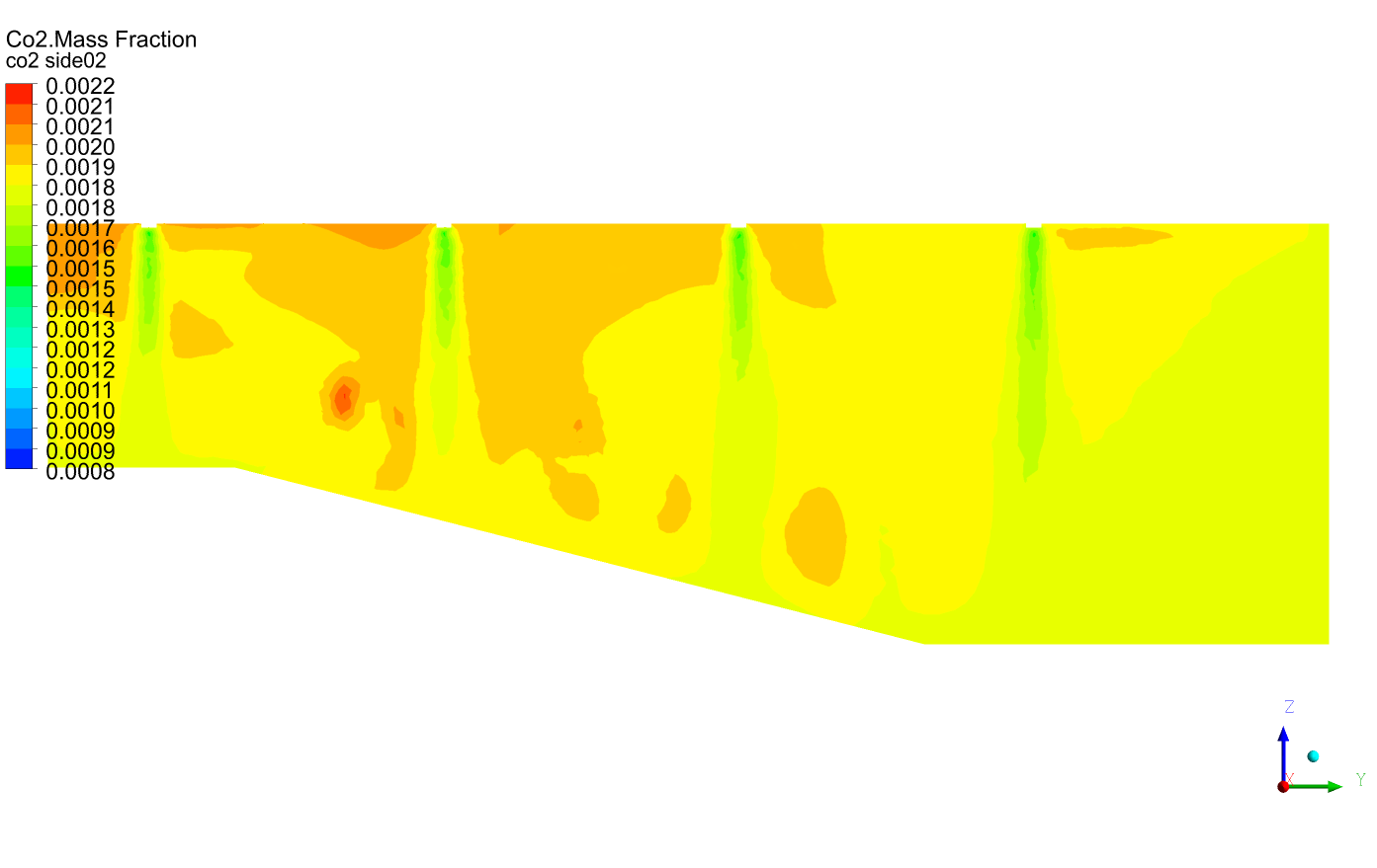

I’ve now adjusted my model to use a source term for CO₂, in the cube( 6cm*6cm*6cm) and put them in front of 5cm mouth inlet, instead of applying them directly at the inlet. For the supply co2 mass fraction, I’m also using expressions to dynamically link the inlet CO₂ concentration to the return air fraction.(0.3 * 0.000759 + 0.7 * Average(MassFraction(species = 'co2'), ['ra'])

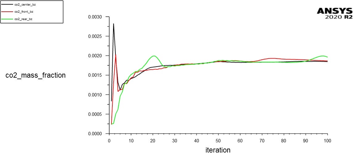

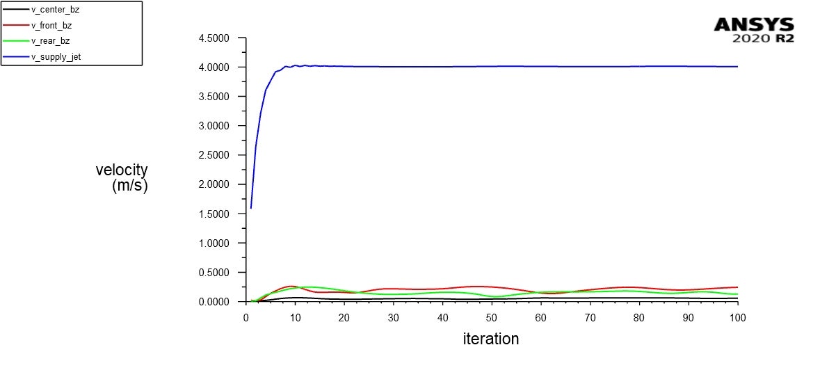

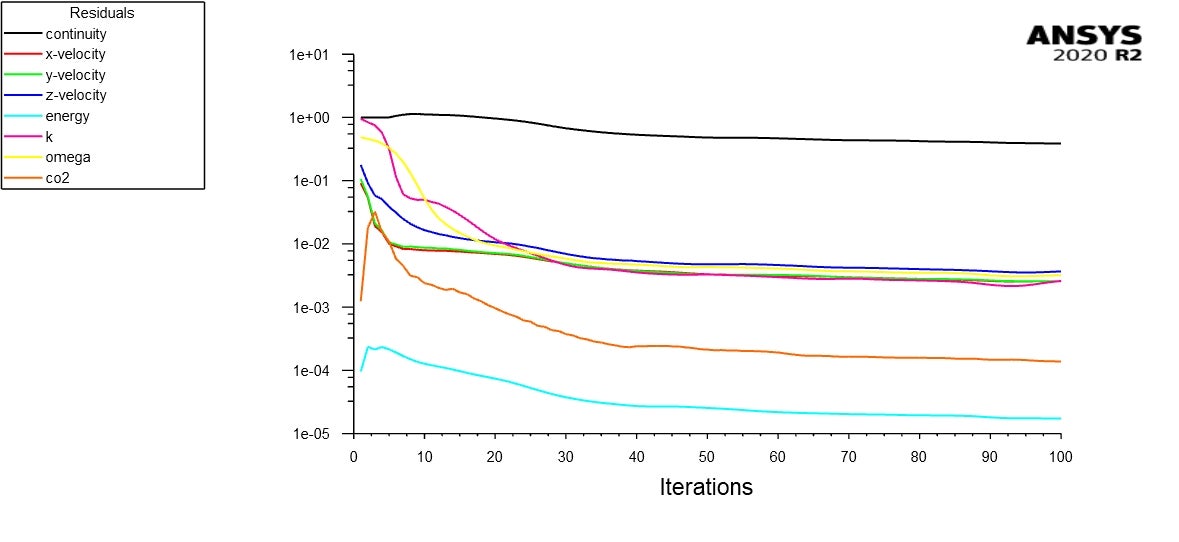

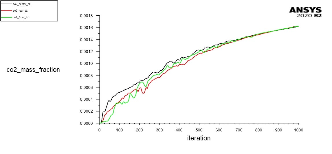

At the moment, I do notice some instability in the early iterations
And yes, I’m using the incompressible ideal gas model for the mixture density.
Thanks again for your help.

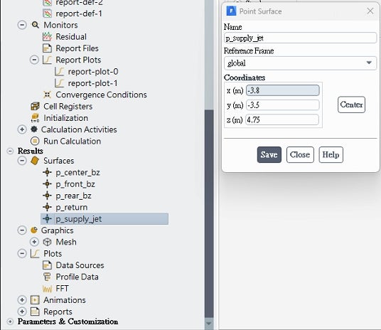

Forum ModeratorYou'll always get some noise in the early iterations as the solver sorts itself out. As I don't know what (ie point/line/surface) you're monitoring I can't judge if it's excessive, but as convergence looks OK later on it's probably not an issue.Â
April 13, 2026 at 3:50 pm
April 13, 2026 at 4:14 pm
Rob
Forum ModeratorPoints are good as they don't smear out any oscillations in the values. But points, lines, surfaces and volumes all have their uses: it just depends on what you need to know.Â
So, for your report it's normal for Fluent to bounce a bit to start with: do some reading on how an iterative solver performs.Â
