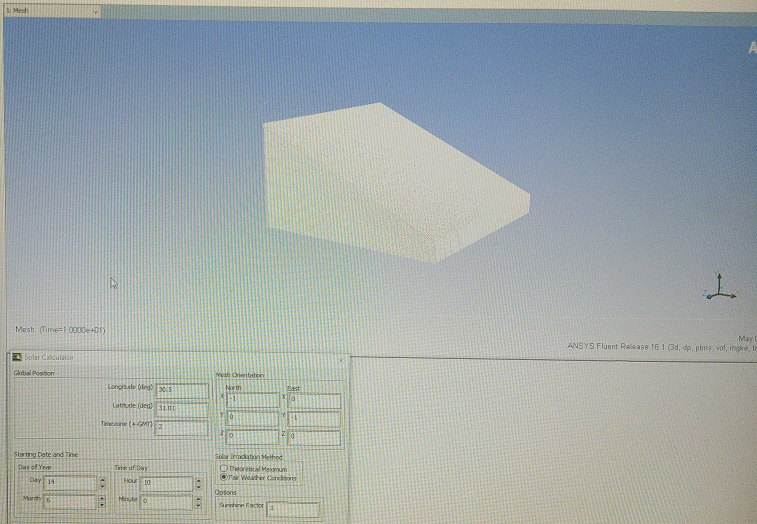

what is this part responsible for in the solar model in fluent , and how it affects the results ?
November 23, 2020 at 4:49 pmRob
Forum ModeratorIt's because x, y and z don't automatically align to North, or up. nNovember 23, 2020 at 6:36 pmAGAAMAZ
Subscribernsorry sir , how can i determine the values of each one in North and East ?nNovember 24, 2020 at 9:39 amRob
Forum ModeratorIf you build the model in CAD, which way is North? It's usually written on the drawings. Take care to ensure you know the difference between site, true and magnetic north: if you ever find out why Civil Engineers need that many definitions please tell the rest of us! nNovember 25, 2020 at 8:00 pmAGAAMAZ
SubscribernIf i want to put the solar still at initial position where its glass face directed to south then run the calculations nHow can i direct it in this direction? nNovember 26, 2020 at 12:48 ampeteroznewman
SubscribernThis screen snapshot is from the ANSYS Help. North is +Y and East is +X that means up is +Z.n
If you use those values, then in CAD, draw your solar still so the X-Y plane is ground and Z is up. Draw the glass facing toward -Y and that is South.nIf you already drew your solar still and the X-Z plane was ground and Y is up, then if your glass was facing the -Z direction the values in the Mesh orientation would be n
November 26, 2020 at 4:52 pmAGAAMAZ
Subscriberthanks sir that was helpfulnNovember 26, 2020 at 6:53 pmNovember 26, 2020 at 8:47 pmpeteroznewman
SubscribernFor the red face to face south, the North column should have Z = -1 and the East column will have X = -1.nNovember 27, 2020 at 12:36 pmRob
Forum Moderatorstrictly speaking won't North be z=-1 and y=-1 as it's about 45 degrees off both? nNovember 27, 2020 at 12:46 pmpeteroznewman
SubscriberArray, mathematically and literally you are correct.nI was using the architectural meaning of the phrase facing south as in the structure is sitting on the ground and the side of the structure that has the window will face south, even though the window is tilted back about 45 degrees. I think that is what AGAAMAZ wants.nNovember 27, 2020 at 2:13 pmRob
Forum Moderatorwe may both be right! It depends on whether it's the domain or the window is referring to. We've given both options so it's over to them. nNovember 29, 2020 at 6:59 pmAGAAMAZ
Subscriber@AGAAMAZ For the red face to face south, the North column should have Z = -1 and the East column will have X = -1./forum/discussion/comment/98533#Comment_98533
@peteroznewman, nthanks a lot for your concernnbut excuse me why X=-1 , isn't the east in the same direction of the +ve X-axis so we should put X=1 for East ?nNovember 29, 2020 at 7:03 pmAGAAMAZ
SubscribernThanks a lot sirn Your clarification in this point helped me a lot .nNovember 29, 2020 at 10:26 pmpeteroznewman
SubscribernYes, you are right, X=1 for East if Z=-1 for North and +Y is Up.nMay 17, 2023 at 6:25 amalperen sevinc
