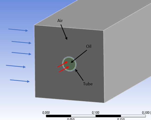

SubscriberI am simulating a tube with a hot oil flow inside and a cold airflow on the outside. (see the geometry below). In the meshing environment, I defined all the different bodies and wall functions (inlet, outlet, adiabatic wall).

AdministratorHello This looks like a conjugate heat transfer problem. When you make the geometry, please make sure your perform the Share Topology operation in Ansys SpaceClaim. This will avoid the creation of contact regions in your simulation (Fluent). You will see coupled wall - wall shadow boundaries and you don't have to manually supply the heat transfer coefficient anymore. Fluent will automatically compute the necessary heat fluxes in your domain.

SubscriberHello Karthik Thanks for your answer. I understand what you mean. After doing the share topology operation in Ansys, the interfaces disappeared. So now I have another question. Because if Fluent is automatically computing all the heat fluxes, why can I still define a convection transfer coefficient at the Wall boundary conditions? Can you use this heat transfer coefficient to compromise the model for differences between the simulation results and real-life test results?

AdministratorAs these are internal boundaries, you will not be able to specify the heat transfer coefficient. The heat transfer coefficient, in a Conjugate heat transfer analysis, is part of the solution.
