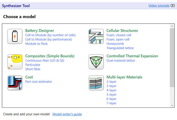

Ansys EmployeeWith the Synthesizer tool you can access in-built models that will allow to:
·       Predict Properties of the following Hybrid Materials: composites, sandwich panels, multi-layer materials, dual material lattices and cellular structures.
·       Perform design of battery modules and packs.
·       Estimate Cost of a part made with different materials and manufacturing routes.
·       Create your own model to perform additional calculations on existing records.Â
