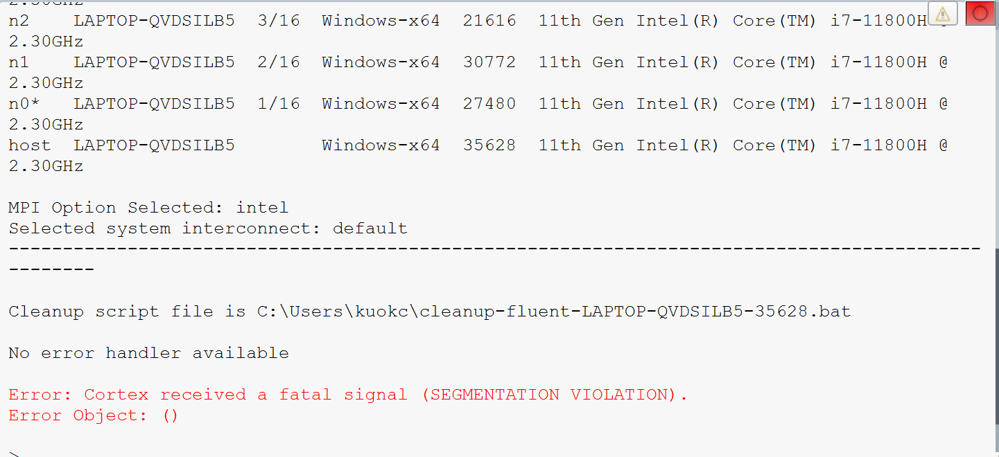

      hey guys, so ummm when i try to open the Fluent this error pops out and saying this:
      Cleanup script file is C:Userskuokccleanup-fluent-LAPTOP-QVDSILB5-35628.bat
      No error handler available
      Error: Cortex received a fatal signal (SEGMENTATION VIOLATION).
      Error Object: ()
      I have no idea what to do... I've tried to re-install the app from 2021r1 to 2022r2... Plz help!
