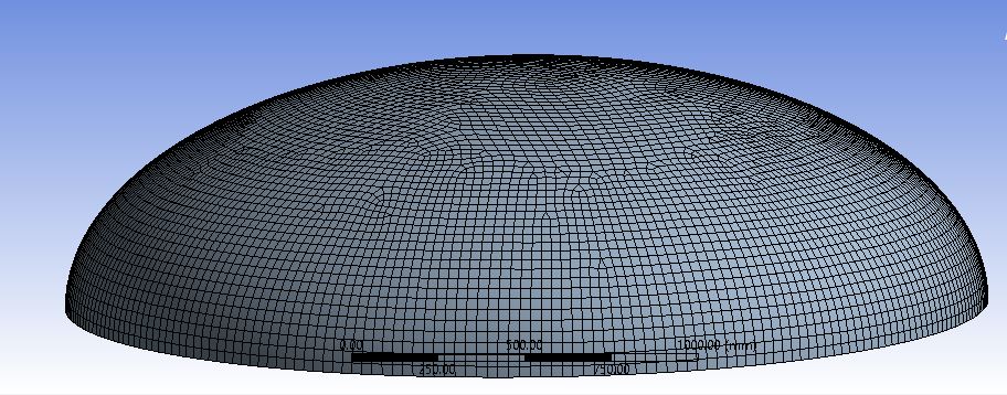

      The default shell element is appropriate for this analysis. Show an image of your mesh.

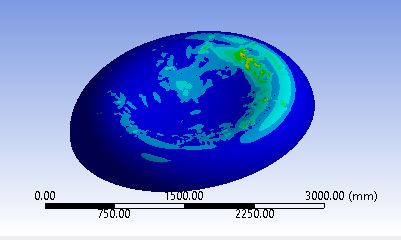

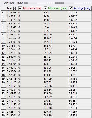

      In my case I am using arc length method, but it does not show any convergence. I am interested in post buckling behavior, because after buckling some structures can retain their load carrying capacity up to some extent. So I need to know how my structure behaves after critical buckling load. I have attached some of the images here.
      after 29th step the convergence error occurs. mostly peoples suggests that arc length will converge solution for nonlinear buckling analysis. But in my case it does not give the converged solution. why?
      How to fix this solution? Here I did not added any material non linearity only 0.2 geometric imperfection.

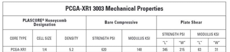

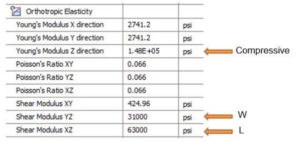

      I already asked you in another post relevent post about sandwich core material properties which is attached here.
      In the plascore datasheet, they did not mentioned any poisson's ratio value. You are taken it in all direction as 0.066. Then how it acts as a orthotropic material?
      If  the poissons ratios are equal, it will be a isotropic material. I want more clarificaton sir.

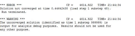

      On the convergence question, it is important to look at the Solution Output text to see what was written to the file when the solver stopped. It is also important to have entered a nonzero value into the Solution Information folder for Newton-Raphson Residual Plots and so be able to look at the NR Residual Force Plot to see the location of the maximum value. Smaller, better shaped elements are often required to allow the solution to continue past the point where it stopped. Another tool that can sometimes help is to insert the command NEQIT,100 into the model. This is useful when the NR Force Convergence Plot shows that the Force line was trending toward crossing the Criteria line and looked like the lines would have crossed, except the solver ran out of allowable iterations, which is 26 by default. The NEQIT command allows it to continue iterating to a higher number.
      On the question of the orthotropic material, it is orthotropic because the Young's Modulus ratio between Z and X or Y is 54, which is much bigger than 1. Similarly, the Shear Modulus ratio between XZ or YZ and XY is 148 or 73, which again is much bigger than 1.  The Poisson's ratio is basically zero (but you can't use zero) and has an insignificant effect on the behavior of the sandwich.

      However, you have mentioned the young's modulus ratio of z and x. In the datasheet they have given only the z direction young's modulus(1.48e5) alone. I did not find young's modulus in x and y directions. Similarly for shear stress also. could you tell me, without young's modulus in other two directions, how the poisson's ratio assumptions applicable. May be I understood it wrong. Please correct me.

      Also, I have run the simulation with NR residuals. The image is given below
      Solution information message. It shows a warning message "CRISFIELD FOUND GAMMA IS TOO LARGE". As per your suggestion I have reduced the mesh size considerably. But, I did not get converged solution.
