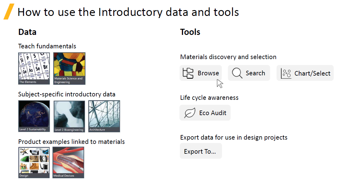

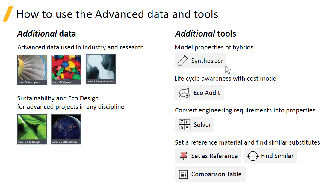

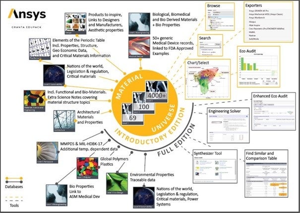

Ansys EmployeeAnsys Granta EduPack is decomposed into 2 editions: Introductory and Full Edition. In the graphic given below, you can find more details about which data or tools you can access in both editions.
GRANTA EduPack Introductory includes Level 1 and 2 databases from all previous CES EduPack Editions, plus the standard MaterialUniverse database at Level 3. The Eco Audit tool is enabled across all databases. GRANTA EduPack includes all the Introductory resources, plus all advanced Level 3 databases. A full complement of advanced selection tools are enabled in all advanced databases, including Enhanced Eco Audit and other tools previously only available in GRANTA (Research) Selector.
