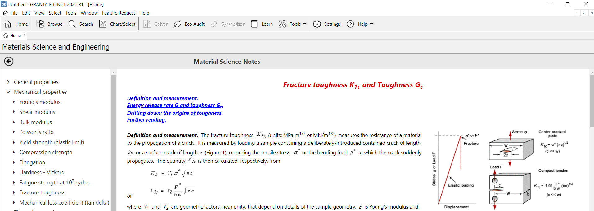

May 6, 2021 at 3:06 pm
David Mercier
Ansys Employee.Hi, you can find some answers in the coming Ansys Innovation Courses in Materials section and in Ansys Granta EduPack as well, which is a unique set of teaching resources to support materials education. See an example of EduPack content below.
