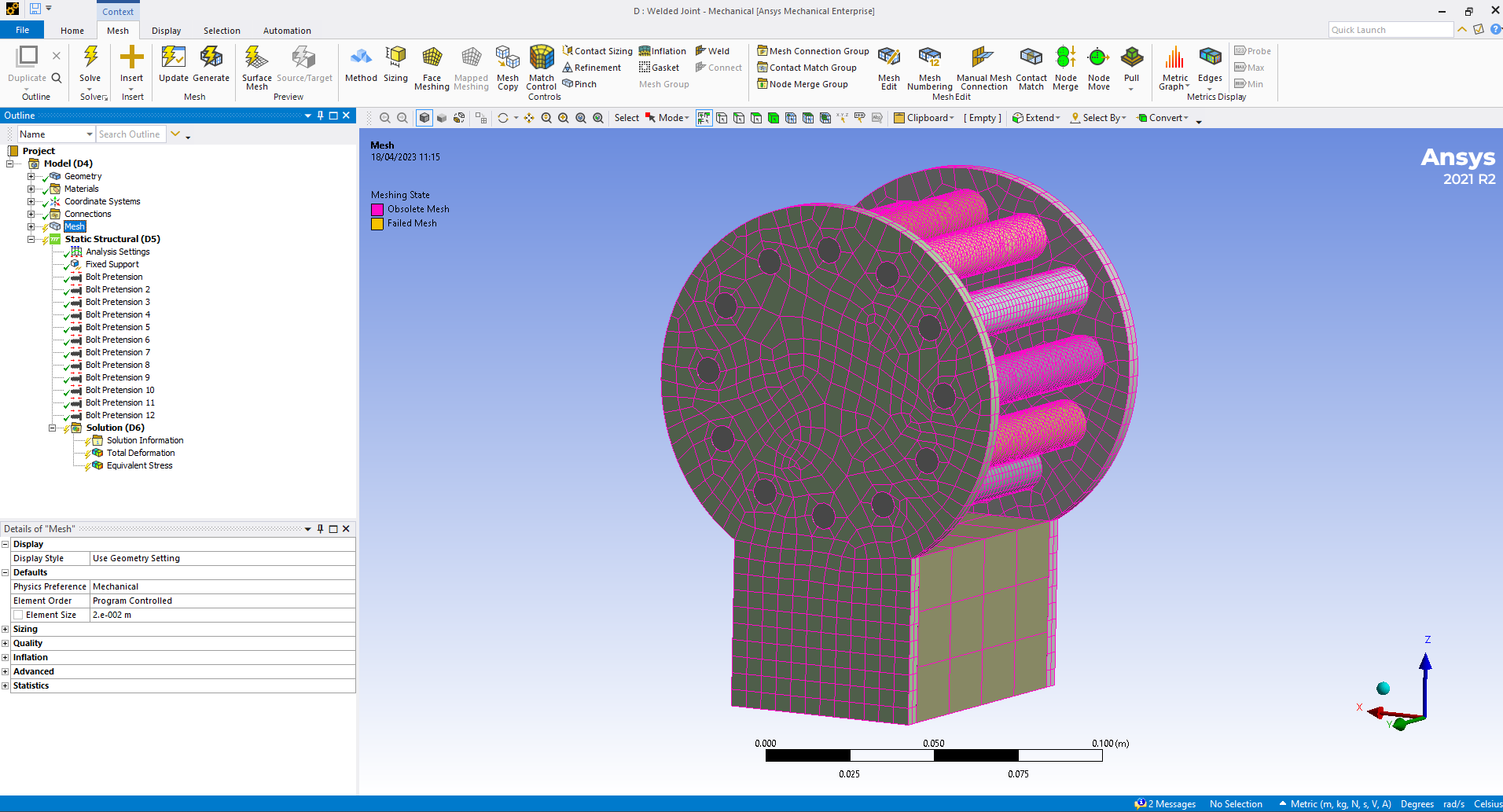

      I have been interested in trying out the weld connections in Ansys. However, I ran into the error that Ansys could not do that due to Batch Connections being turned off. I have Ansys 2021 R2 but I could not find the Batch Connection Setting nor interface, does anyone know where I can get it?
    • ErKo
      Hi
      Batch Connections are used for achieving connections in structures made of sheets/shells and beams. Batch Connections uses Connect objects to connect the beams and shells.
      See help for more info if needed but the above explains that it is not available with 3D solid/volumes (only with shells and beams).
      To connect 3D solid/volumes use share topology or bonded contacts.
      All the best
      Erik
