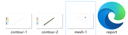

I have finished an calculation and view mesh and contours in Results-Graphics. What's more , I found a folder containing mesh , contours and .html named report was created at desktop. Those grapics are not origin window resolution. Instead, they are 4k as I have set before in "save picture". It's embarrassed that I forgot what I have done to realize it.
Do you have any idea?Highly appreciated that!!!!!!!!!????

Open the save picture option in Fluent and in the resolution settings turn on the "Use window resolution" option. Now hit "apply". Now when the solution animation prints out animation images, it will be at a reduced resolution.
