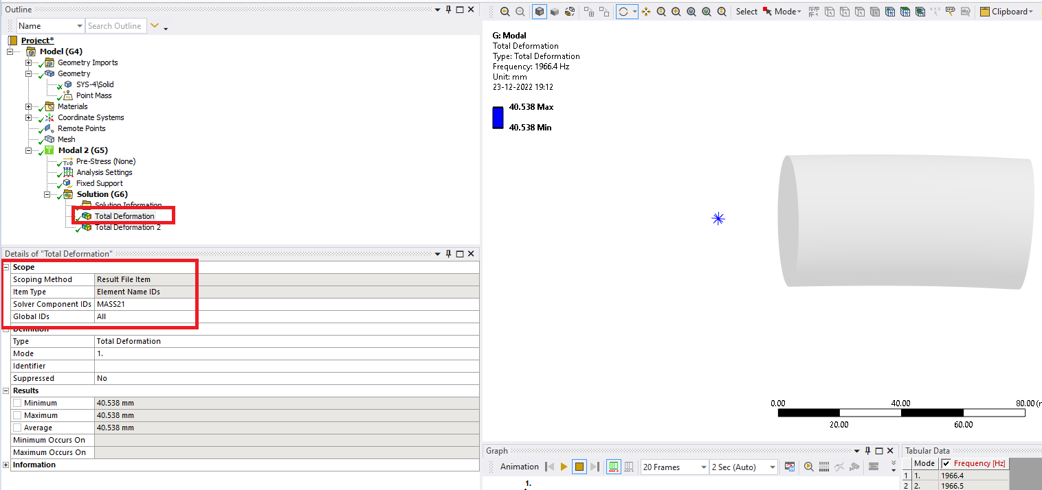

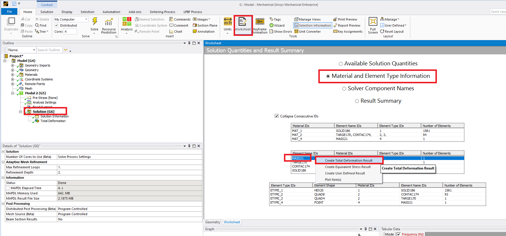

SubscriberIm doing Modal Analysis of a system with many point masses.
In the visualisation of the solution (in Mechanical) I only see the displacement of the grid, but not the displacements of the individual point masses.
Is there any simple way to visualize the displacement of these point masses?

Otso Gächter
SubscriberHi Akshay
Thanks for your detailed and easy to follow response
Is there any way to combine this visualisation with the deformation of the other geometry (meshed)?
