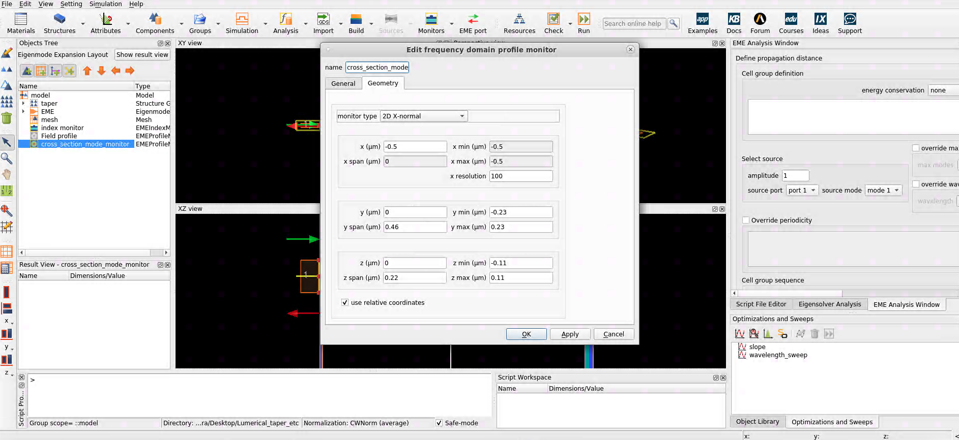

SubscriberHi, I am following this linear taper example (https://support.lumerical.com/hc/en-us/articles/360042800413-Linear-waveguide-taper) but I would like to add a mode field monitor to visualize the YZ mode (X-normal) instead of the XY mode (Z-normal). I have added a new monitor (cross_section_mode_monitor) and disabled the existing one (Field_profile) accordingly, but when I run the simulation, no results are loading into the new monitor and I cannot visualize the YZ field. Will you please let me know what I am doing wrong here? This forum does not allow me to upload .lms files so I have attached a screenshot of the new YZ monitor settings. Is there a way I can upload my .lms file? I am using Lumerical through a university license.

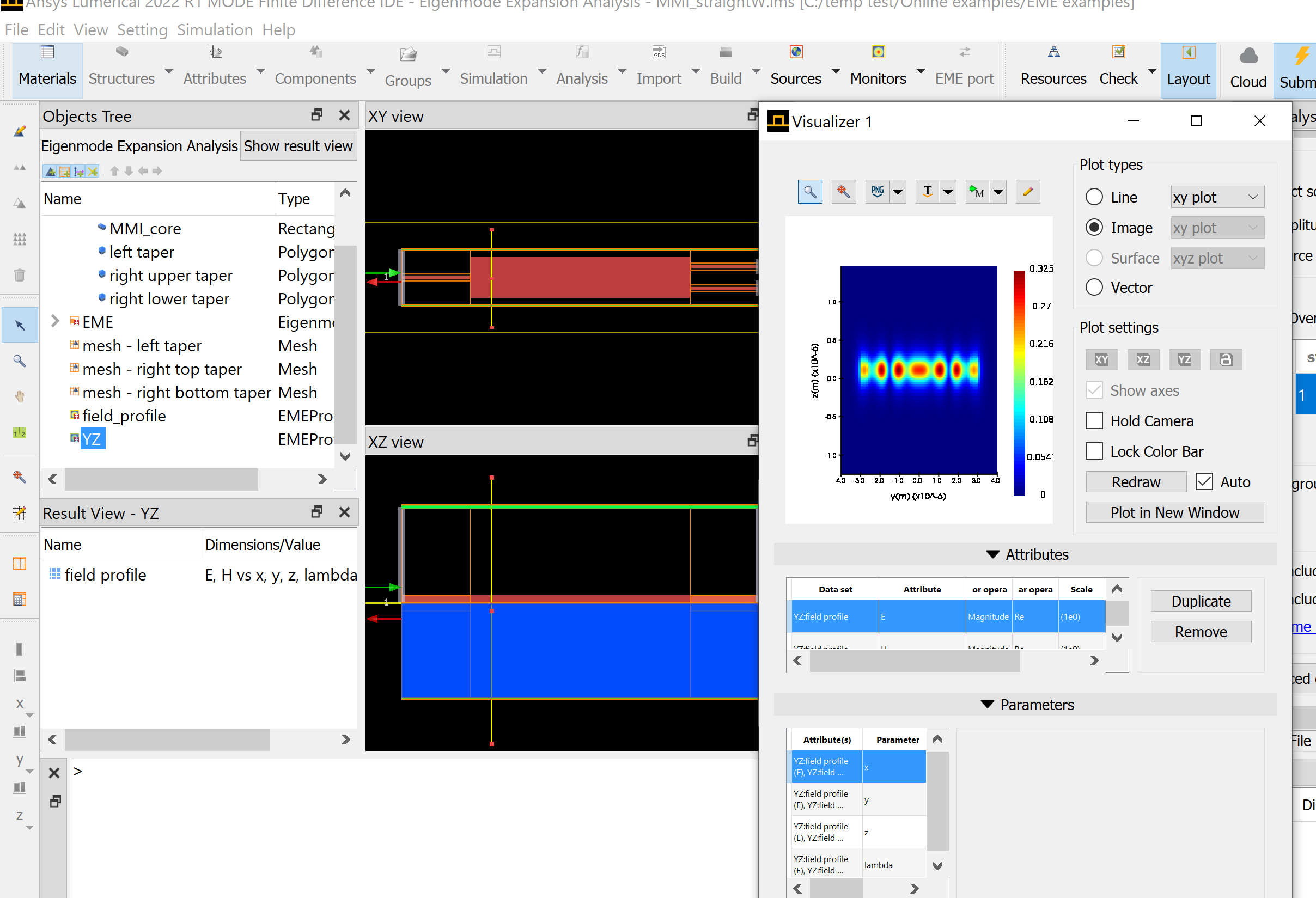

January 28, 2022 at 9:34 pmGuilin Sun
Ansys EmployeeDid you run "emepropagate"? I tested and there is no any issue showing yz profile:

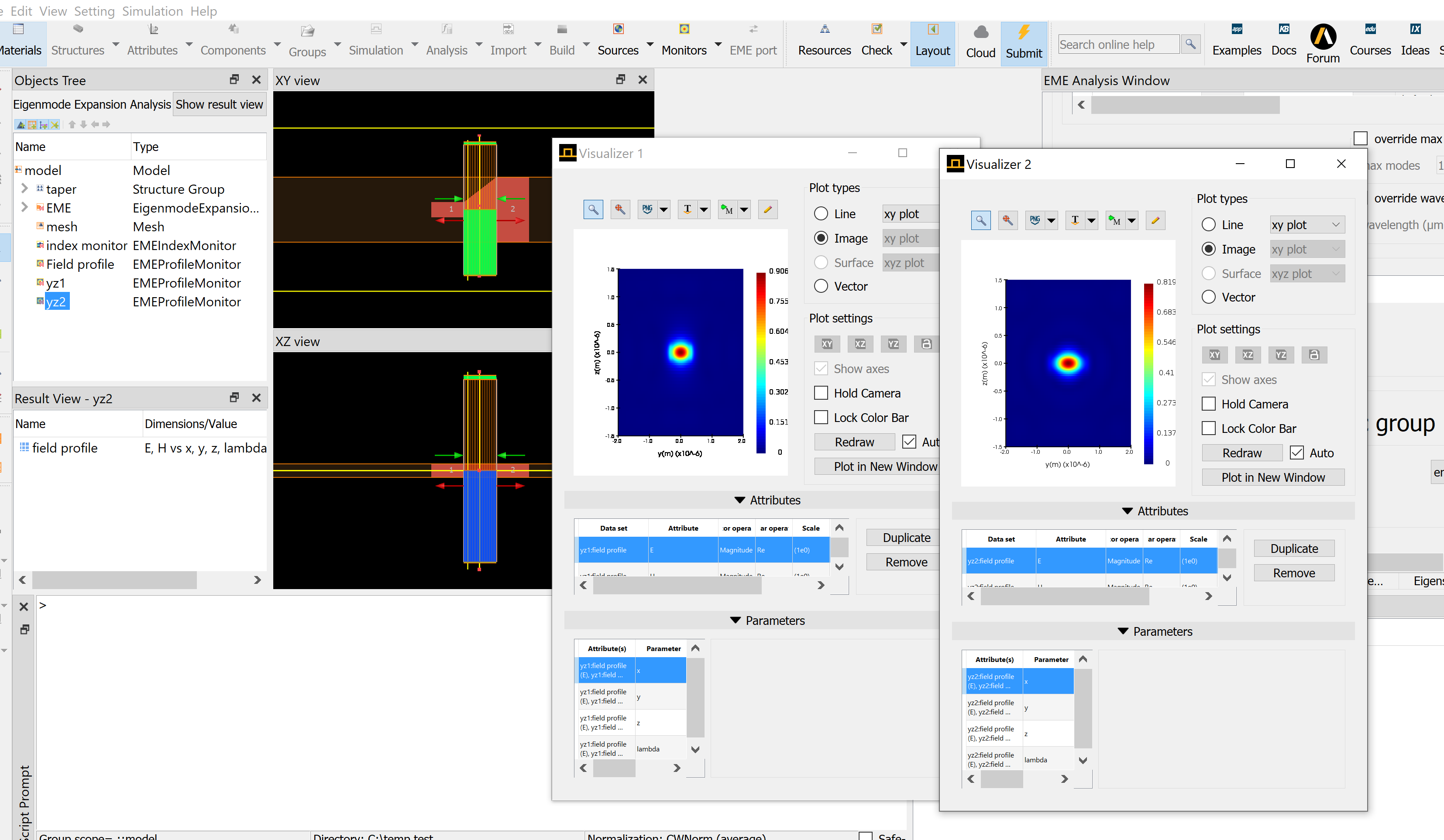

January 28, 2022 at 10:24 pmaberg
SubscriberThanks for your reply! Please note that I am using the Linear taper example (https://support.lumerical.com/hc/en-us/articles/360042800413-Linear-waveguide-taper), not the MMI example in your post above. I did indeed run eme propagate. But the YZ monitor I put at x = -0.5 (middle of left narrow waveguide region) did not update with any results.

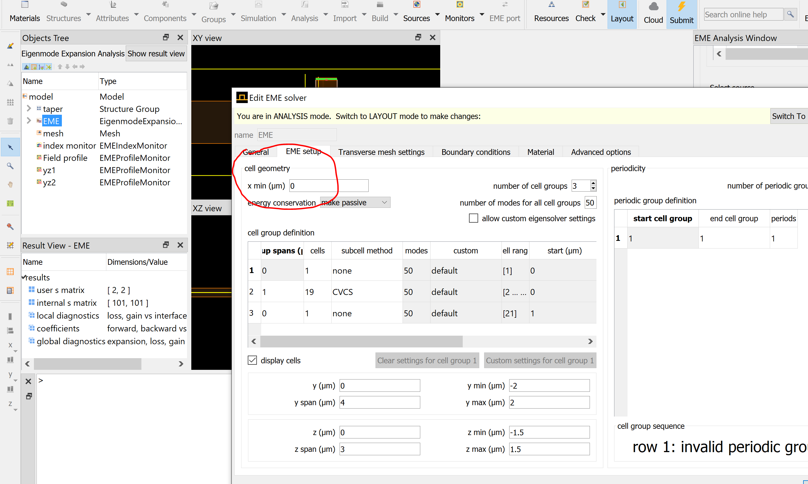

However, I noticed that when I move my YZ monitor to the right of x = 0 (for example to x = +0.5) and re-ran eme propagate, the monitor updated with results and I could visualize the mode. I do not understand why the monitor failed to update with results when it was to the left of x = 0, but updated with results when placed to the right of x=0. The location of the monitor along the waveguide taper should not matter, correct?
January 28, 2022 at 10:50 pmJanuary 28, 2022 at 10:56 pmJanuary 28, 2022 at 11:07 pmaberg
SubscriberThank you! The issue was that the simulation region did not include x < 0. So now I extended the simulation region to the left and the monitor shows results.

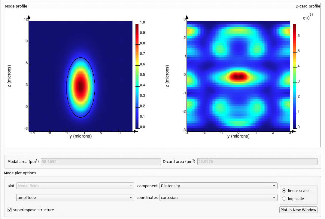

SubscriberThank you. I have a question about the mode field visualization in the Lumerical edge coupler example (https://support.lumerical.com/hc/en-us/articles/360042305354). I am looking at Step 2: Initial EME optimization of taper length without substrate. I do not understand how the mode profile at the bottom left corner of the figure in Step 2 was captured. It is the biggest mode at position x = 0 along the coupler. I downloaded the example file and see that "monitor_2" is meant to capture the YZ mode profile. It is set at x = 145 um by default, which is somewhere in the middle of the coupler, not at the edge where the fibre couples. So I changed the monitor position to x = 0 um to capture the mode at the edge because this is what is important for fiber coupling. But when I visualize the result from the monitor, I see something that looks like a plane wave, not a guided mode. Where should I put the monitor_2 along the x axis to capture the mode at the edge correctly?
Also, if the mode profile at the bottom left corner of the figure in Step 2 on the website is correct, then why does it not match the mode profile in Step 1? In Step 1, the mode at the edge was found using FDE at the x = 0 position, and the overlap with the fibre mode was calculated. But that mode in Step 1 is apparently much smaller than the mode shown in Step 2, both at x = 0?

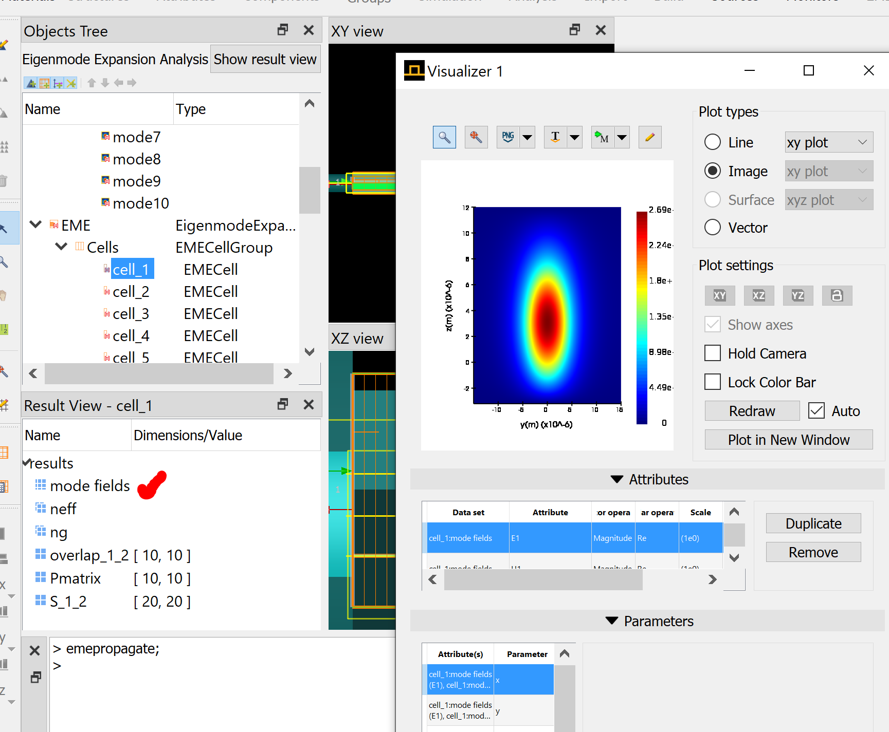

February 8, 2022 at 12:08 amGuilin Sun
Ansys EmployeeIn EME, each cell represents a section of the waveguide. therefore, the modes from each cell shows the modes at that waveguide section (center of the cell). Please zoom in and see which waveguide cross section it represents. You can also find the location from a simple calculation from EME settings, as you should know the group length and number of cells.
As for the overlap, you can extract the mode data:
getresult("EME::Cells::cell_19","mode fields");
it will give you all the mode fields for cell 19. Then you can extract a specific mode E and H components. You can see the data variables in the work space.
Than you can do overlap calculation using your own script, following the formula online, with all the field components known. Please try. If you have questions regarding to the script, please write another new post. Thank you!
