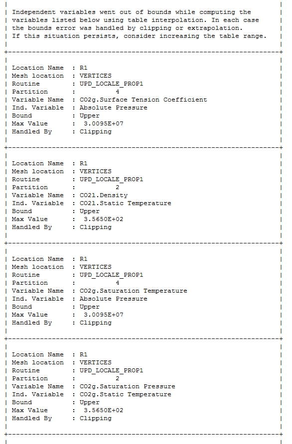

      I’m simulating the flow of CO2 condensation. I use the Non-equilibrium Phase Change with CO2 liquid and gas defined in RGP file. The first time I didn’t select the nucleation model. The solver always alert that some variables went out of bounds like this:
      warnings
      It puzzled me when I examed it in details.
      For example, the second variable CO2l.Density(liquid CO2 Density) is listed becasuse the CO2l.Static Temperature(Max value 347.69K) is upper than tabluated.  But actually in the Liquid CO2 RGP table, temperature range is up to 450K. And in my opinion, when the temperature is 347.69K, the solver should read properties from Gas table rather than Liquid table.
      The same questions occurs to other variables like CO2g.Saturation Temperature.It is Absolute Pressure as large as 16.98MPa that result in the error. But when the pressure is up to 16.98MPa, it is far away from the critical pressure(7.3MPa), which means that it is in supercritical region and there shouldn’t be any saturation data, let alone CO2g.Saturation Temperature.
      Is there any reasonable explanation?

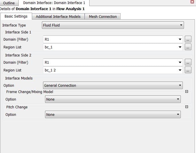

      1.  The object of the simulation is an impeller. For B.C.,details is in follow:
      Inlet: Total Pressur and Total Temperature(307K) for Gas CO2 phase, as well as volume fraction and droplet number as 0 for Liquid CO2 phase.
      Outlet: Total pressure
      Interface: the interface here is a clearance between impeller and shroud surface. Details are in picture.
      The fluid model setting is here:
      2.  Yes, a single phase of Gas CO2 works fine and I use it as an initialization for multiphase simulation. I try the multiphase because there seem to be a very small region where condensation may occur.

      Thanks for your prompt reply. As suggested I have made some try in the following aspects:
      1.Use IAPWS library rather than RGP file. There are no warnings.
      2.Remove the clearance from the geometry, so that no interface setting is needed. However while using CO2 RGP table, the warnings remain as follow:
      Perhaps it is the RGP file that matters. But since it works well in single phase(liquid or gas) simulation, I’m confused why they don’t work in combination.
    • DrAmine
      Bear in mind that even if the range tells you that you expecting vapor or liquid to be there the solver is always calculating properties for both components. Sometime the warnings might be ignored as they probably disappear as the solution proceed.
      Which ranges require for your CO2?  Can you extend the range?
