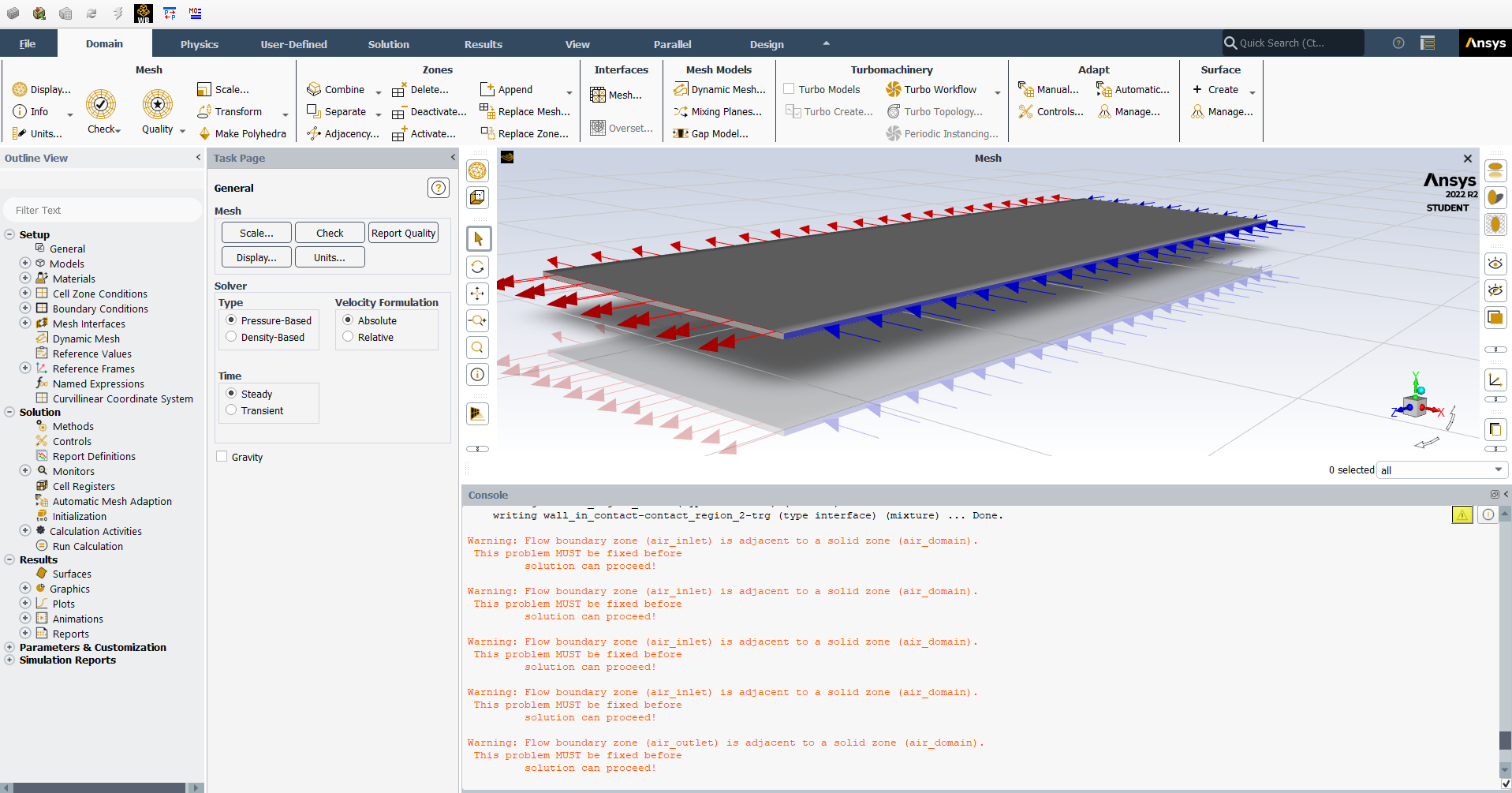

TAGGED: ansys, ansys-fluent, fluent, heat-transfer
February 8, 2023 at 4:07 pm
February 9, 2023 at 7:30 am
SRP
Ansys EmployeeHi,
The problem can be solved by changing the cell zone. Change cell zone of solid to fluid.
Hope this solves your problem.
Thank you
Saurabh
