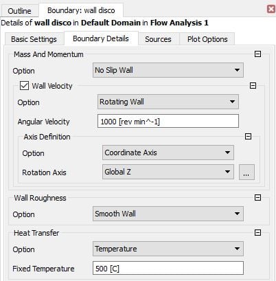

      I am simulating a simple model of a brake rotor to check the wall velocity configuration. The model is only a stationary fluid domain. I attach a picture of the model, the rotor wall boundary and the wall velocity setup.

      However, the following mistake message appear when I run the simulation:
      ERROR #002100080 has occurred in subroutine CHECK_NORMV.
      Message:
      The specified velocity vector on the boundary patch
      wall disco
      has a significant normal component at one or more faces. One of
      these face locations is
      (x,y,z) = ( 2.21063E-02,-2.78752E-02, 2.33333E-03).
      The angle between the specified velocity and the element surface is  87.597 degrees at this face. This is considered an error because
       it implies that the mesh is moving.  The following are possible
       Reasons for the error message:
       1. There is a setup error; for example, an incorrect axis of rotation.
       2. There may be a meshing problem; for example, the nodes on a rotating surface might not lie on the surface of revolution.
       3. The boundary is curved and the mesh is very coarse. In this case, you may modify the tolerance by increasing the expert       parameter 'tangential vector tolerance wall' from its default of 20 degrees.
      I have checked the mesh and the axis of rotation but I can't solve it.

      if there is normal motion then it would not wotk. The motion without frame change or mesh deformation can only be done tangentially. So you need to define one stationary and one rotatory zone.

      You are right about the needs of a frame change, but I had a doubt about the wall velocity when I read in the tutorial that it can be used in stationary and rotating domains. I will set up a stationary and a rotating domain as you advised me.
