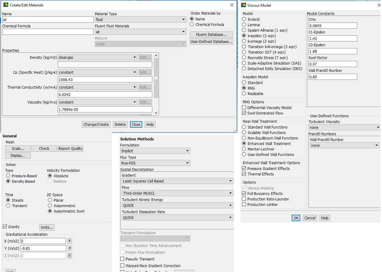

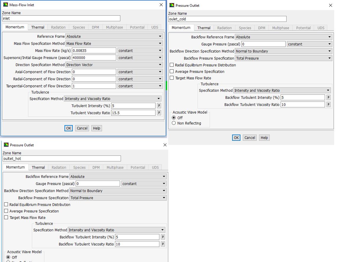

while simulating the swirl and temperature difference in the vortex tube in the 2D modelÂ
the temperature seems to be constant and wrong despite enabling the energy equations with density-based solver
with pressure based solver the console reported that the dot product is zero for some node and then it stopped workingÂ
i made the velocity vector tangential and used the ideal gas properties.

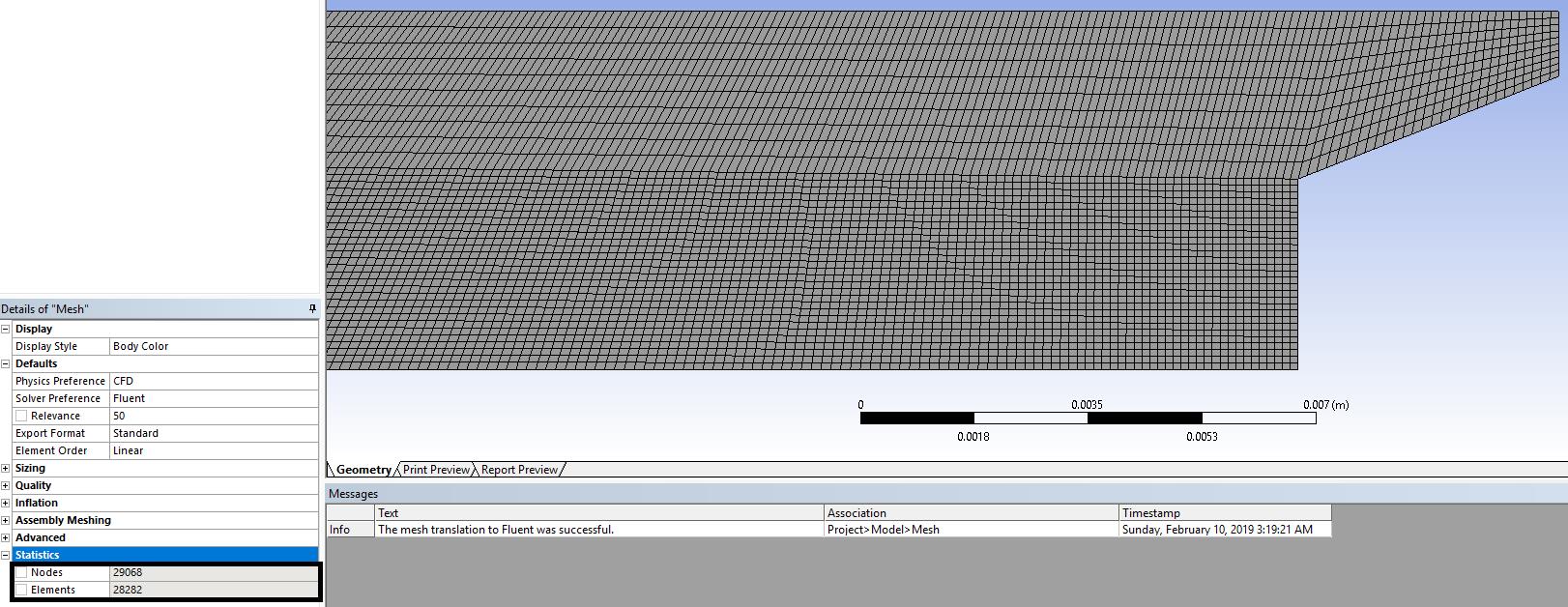

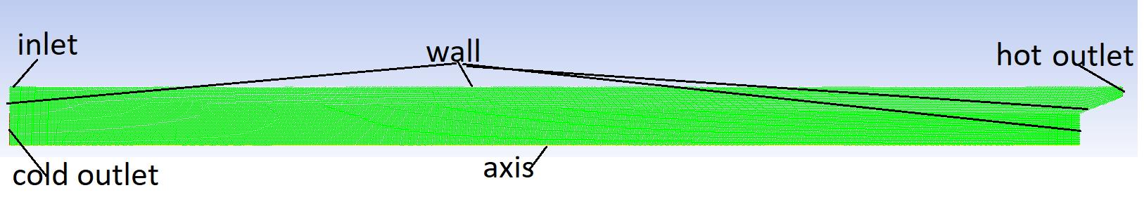

DrAmine
Ansys EmployeeThe geometry does not look axis-symmetric.Â
I would rather use Pressure based solver for this kind of low-Mach-number flows.

February 14, 2019 at 8:09 pm
DrAmine
Ansys EmployeeYour geo. Is not axisymmetric. Please add zoom of inlet region.
February 14, 2019 at 8:35 pm
ahmed335
Subscribersorry , you asking me to zoom the inlet region ?
can you tell me what to do to make it axisymmetry ?
February 15, 2019 at 8:21 am
DrAmine
Ansys EmployeeThe geometry you are referring to is not axis-symmetric: You have that tangential inlet which is not evolving around the axis.
