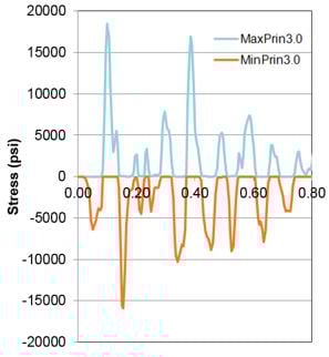

SubscriberWith Equivalent von-Mises Stress, you can't tell if it is tension or compression.
Plot Maximum Principal Stress to see the stress that is most tensile (or zero).
Plot Minimum Principal Stress to see the stress that is most compressive (or zero).
Below is a plot of those two stresses vs time at a point on a part that was vibrating.
The point was going from tension to compression as the part bounced around.

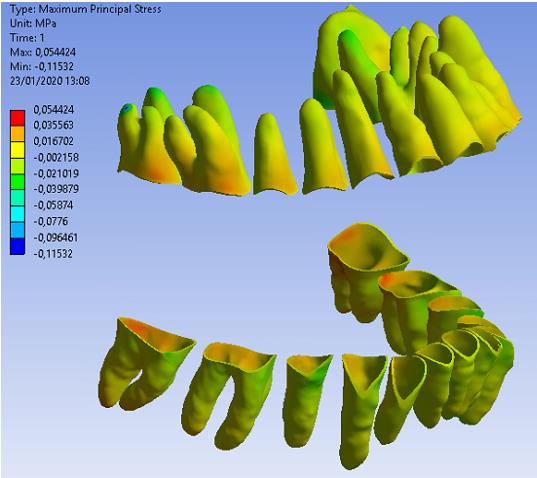

SubscriberShow an image of the Maximum Principal Stress plot.
It is easier to understand the concepts for a 2D state of stress. Read up on Mohr's circle.
If all components of stress are compressive, for example with hydrostatic pressure, then the Maximum Principal Stress can be negative.

m.caragiuli
SubscriberHi,Â
this is the plot of max principal stress
here a force is applied about at the height of the 4 body (from the left) and points downward and forward, thus it makes sense that anteriorly bodies exhibit compression. However, the plot is about maximum principal stress, not minimum. Here not all the components are compressed, some parts are tensioned (positive value).
Thank you!
