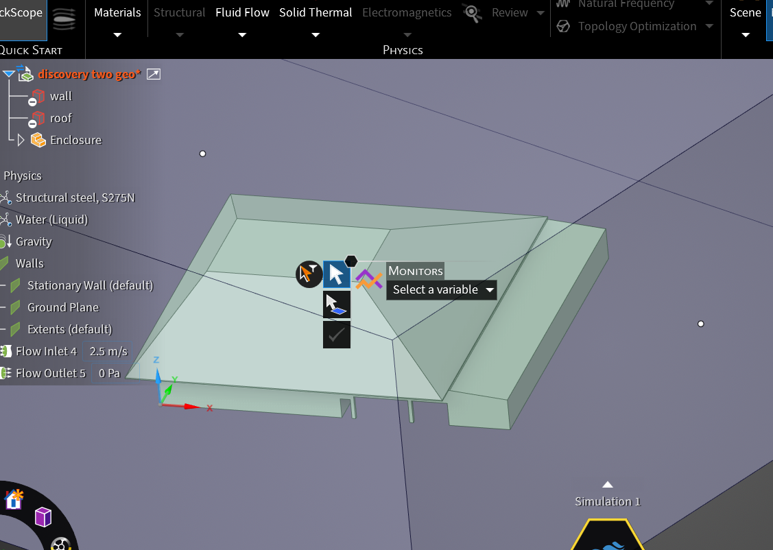

      hi, im using loft tool for the roof. Ive tried the surface loft (wont work in volume) and the 3d model in lofting in spaceclaim
      but when im doing a volume extraction it only read the volume floor - upto - the roof surface level (3d Model) (pic attached). or i dont need to use volume extraction no more?, i can just go with the enclosure?
      can u help me please
      my study is to simulate fluid flow from outside - inside - outside
      thank youuuu
      note: the surface there is the ground, volume 1 (walls), volume 2 (roof - pyramid like)

      I am having difficulty seeing what you are trying to do here. Try naming the solids to something that helps us understand what we are looking at. Here is what I think I am seeing:
      1. The highlighted orange volume under the volume component is the interior fluid volume of the barn.
      2. One of the solid bodies is the interior rooms of the barn where the movement of the fluid is not considered. These will be “dead” volume with respect to the simulation.
      3. There is another Solid Body, I am unsure what this is. Maybe this is the outer walls? If so, you may not want to have these bodies have a physical thickness that you have to resolve. Instead treat them as a thin baffel.
      4. The Surface body which is currently the shape of the roof. You likely had difficulty because the “starting” cross-section changes in the z-direction. I would simply loft from the lower square to the upper square. You can then remove the overlapping region with the Solid Body from (2) using the “Combine” tool (yes the name is a bit confusing).

    • V.P
      Hi 20-1-01423,
      Since youa re interested in fluid flow from outside to inside, then an enclosure will be the right approach. But you need to provide wall thickness to building and roof walls, or else enclosure tool wont work. With enclosure, you dont have to worry about inner wall naming and door naming.

    • V.P
      No it wont take too much extra processing.
      The idea is to create the building with wall thickness. then create enclosure using the Enclosure tool. This will create a region enclosing the solid wall region. And now you can delete or deactivate the solid wall region before exporting for meshing. Or if you prefer not to delete/deactivate, you can in fluent meshing, specify the solid wall region as DEAD zone, so it wont mesh that region. So you only end up with only the fluid region. Since you are only interested in fluid flow, there is no need to mesh the solid region,

        • NickFL
          IF you are going to go down the road of adding thickness to you walls, then yes this looks decent. What is the relation of the wall thickness to your building dimensions? If the ratio of throughwall thickness to building dimensions is small then you are going to waste a lot of cells through the doorways/windows/etc.
          As for creating a dead zone, you can just right-click the object and select suppress for physics. This won't send it to the next application, and the faces of this object are still there (on the fluid side) so you can apply the no-slip to these faces.
          Two things from my side:
          1. I expect your outside environment is not large enough here. You may need multiple sizes of the building to accurately capture any downstream wake.
          2. I think before you had an opening on the top of the roof, correct? If so, you will want to have this also be treated like your doors. (Sorry if I am confusing you with another poster.)

    • V.P
      Hi
      To make things more clear, I am pasting the workflow steps below.
      Idea is to remove solid zones in the flow path. Your case has walls, which is the solid region. We dont have to mesh this region as we are not simulating the solid thermal properties.
      So by remowing this region, we only end up with walls. Only the volume becomes empty, but walls are left behind.
