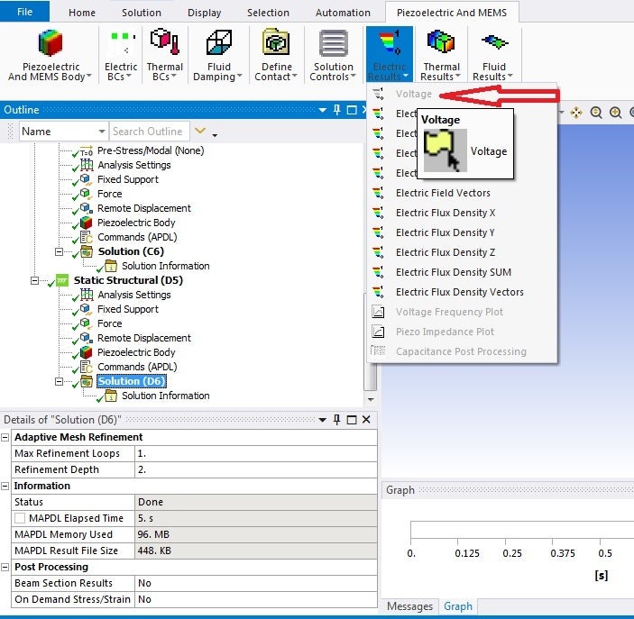

Subscriber.Hello,
I have problem to get output voltage from ansys workbench.
Currently, I am use piezo n mems extension to set the piezoelectric data (Ansys Version 2019 R3, Extension mems Version 190.1)
Unfortunately, I cannot be determine output voltage at static structural and the icon is blanked symbol.
Please refer figure.
Thanks for the feedback.
March 30, 2023 at 5:03 pm
zain ali
Subscriber@syafiq1986 did you figure it out, how to ass electric result voltage. I am having same issue.
