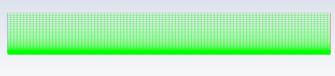

SubscriberWhat is our maximum Courant number? Could you post some pictures of your mesh? (If possible, superimposed with the volume fraction contour)

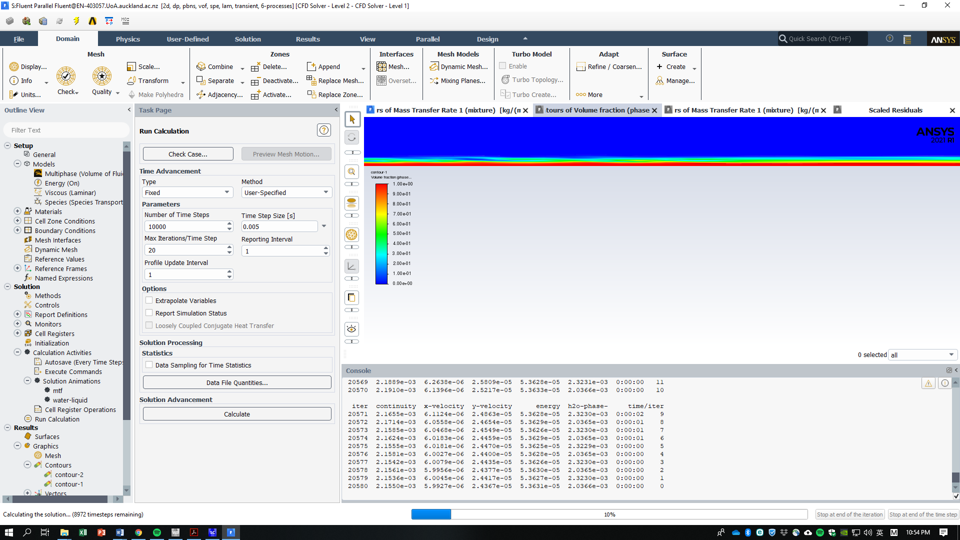

June 28, 2021 at 8:32 amb404957074
SubscriberI understand, that the reason why I used my own code to deal with the saturation temperature. The UDF I used describes the relationship between water vapour pressure and saturation temperature.
As the pic shows, evaporation does happen.

SubscriberHi Aitor My inlet velocity is 1 m/s, mesh size is 0.002 m, the time step is 0.01 at the moment. The Courant number is around 5. I know it is a bit higher than what it should be, but as you may already know, natural evaporation is quite a slow process, hence I want to time step to be as large as possible.

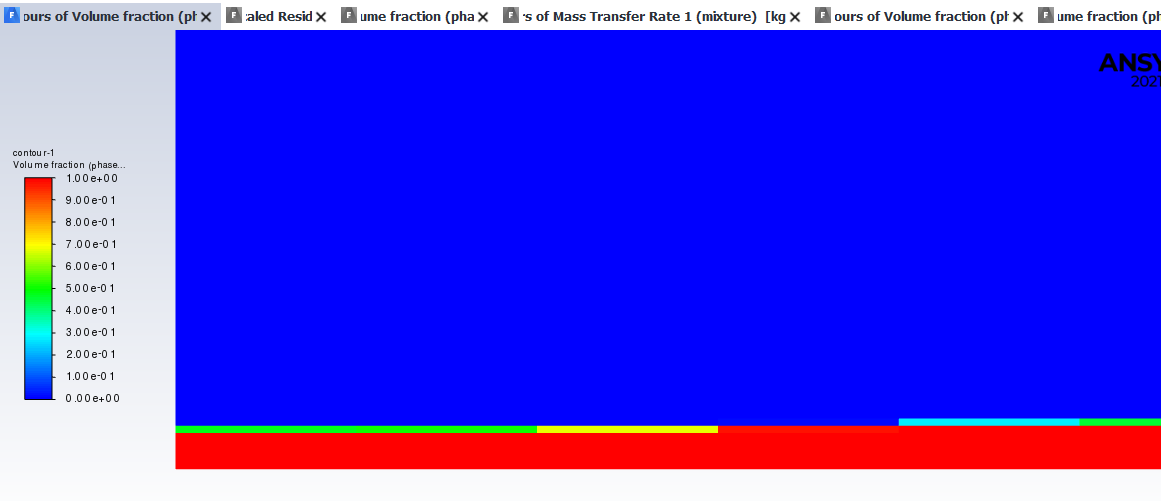

VOF and Phase Change: Actually you need to have a diffuse interface otherwise you do not have any mass transfer. Now show with nodes values OFF the VOF distribution in the interfacial cells (perhaps a time mean).
June 28, 2021 at 10:24 amb404957074
SubscriberHere you go, after switching the node values off, it seems more reasonable. However, the evaporation rate should be well-tuned through the experiment.
The pic shows the result after 72 seconds of simulation. The thickness of the water layer dropped down from 0.8 mm to 0.4 mm.
I will dig a bit deeper into Eulerian Wall Film later on. But a Diffuse interface? How to set that up?
June 28, 2021 at 4:32 pmDrAmine
Ansys EmployeeNode values are sometimes confusing but they only affect post processing (node neighboors are used for some internal stuff in coding). There are some way to diffuse interfaces. If your Film is thin and laminar ewf is good way.
