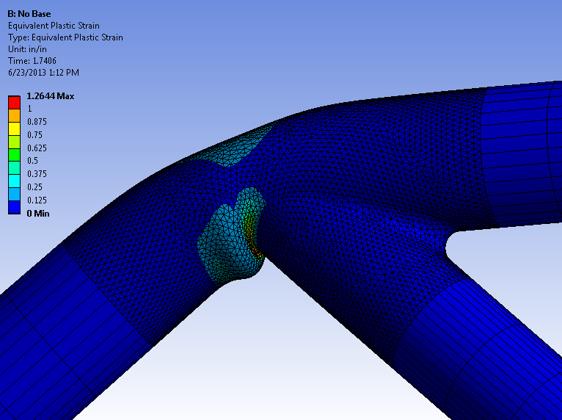

SubscriberThe effort required to have an all hex mesh is too much and unnecessary. You can get excellent results using tet elements. By slicing the body up to leave some parts sweepable while other parts are not, you can get the benefit of reduced node and element count by sweeping where you can and use tet elements where you cannot sweep. Below is an example.
