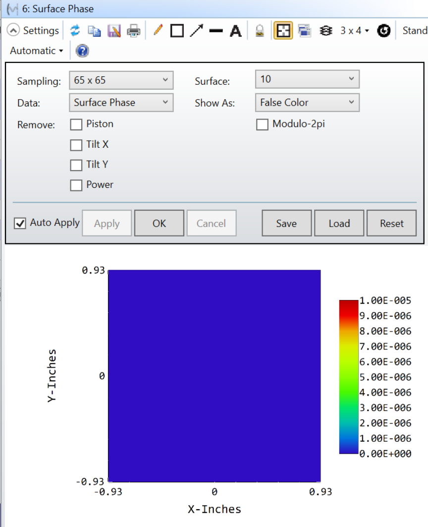

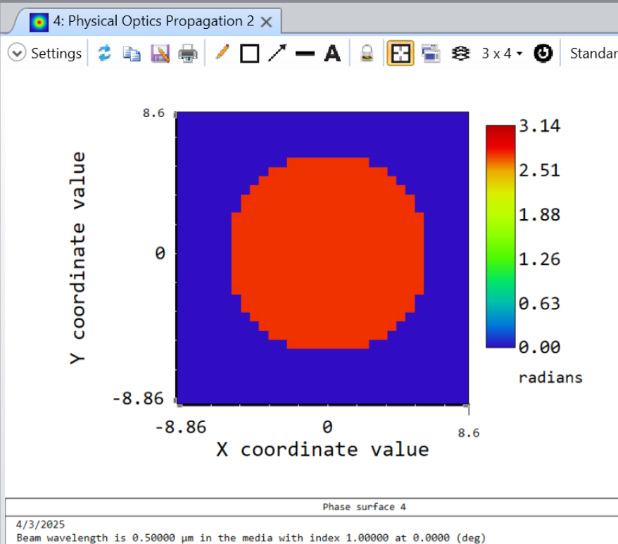

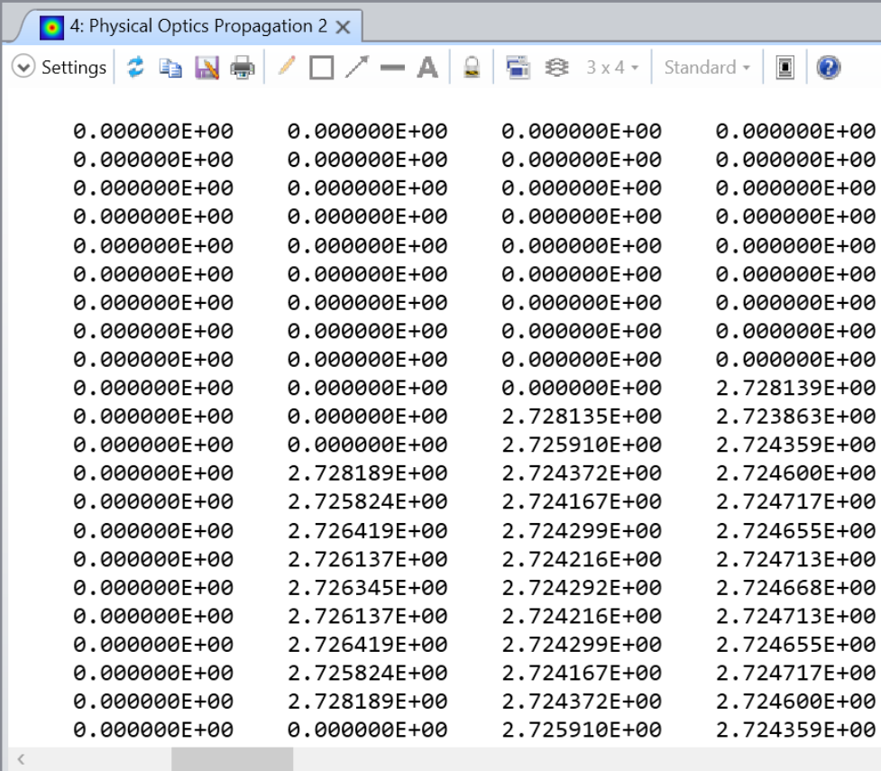

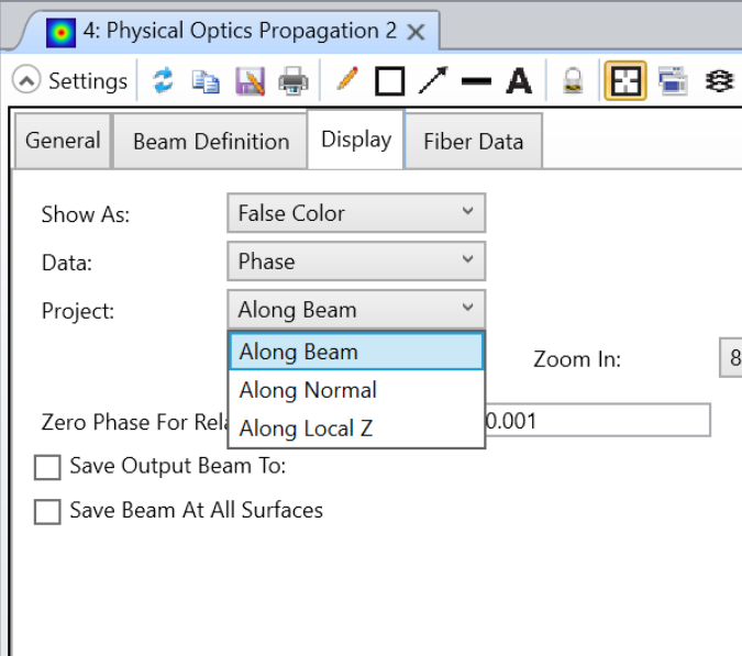

SubscriberI have so far been unable to find a tutorial on constructing phase maps of surfaces in Zemax. (The closest thing I have found is a video tutorial in which the user imported a grid phase object and was therefore able to see the phase of the object imported.) I would like to be able to take an arbitrary slice normal to the propagation axis in a sequential optics simulation and capture it as a grid phase equivalent, either by exporting as a .zbf file or by copying the text output from the monitor. My expectation is that there should be a radial distribution of phase since the different rays travel different distances to reach the image plane and accumulate phase in proportion to distance travelled. I have attempted to view phase using two of the sample files: 1) Sequential>Objectives>Double Gauss 5 Degree Field.zmx and 2) Physical Optics>POP through a wave plate.zmx

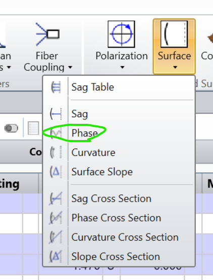

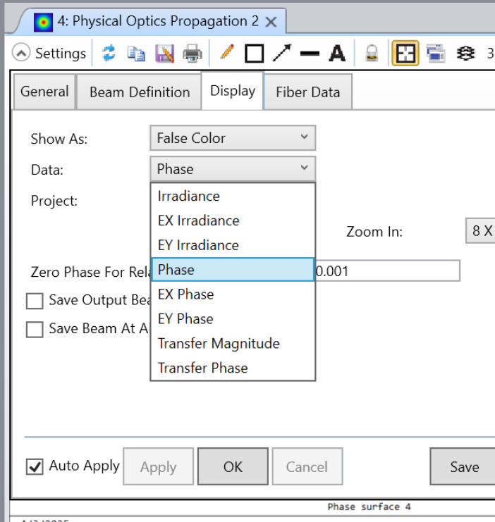

In the former case, I always see 0 phase regardless of which surface I select:In the latter case, I see a constant or nearly constant phase. Also, I don't see any difference occuring based on which "Display>Project" option I select (i.e. "Along Beam," "Along Normal," or "Along Local Z") :
Of course, in this case, I'm sampling at the zone plate, so there may not be much phase accumulation yet. However, I see essentially the same thing when I insert a surface between the zone plate and the image plane and sample at that surface instead.Â

Ethan Keeler
Ansys EmployeeFor your first example, the reason you see no phase is because the surfaces used in that design are simple Standard surfaces. These surface definitions themselves do no impart phase, unlike surfaces like Grid Phase or Binary surfaces. There are two way surfaces in OpticStudio add phase, either you have a sag profile defined for a refractive medium or you have an explicit phase profile defined (or both). The tool that you are looking at (Surface Phase) only would show a phase profile that is explicitly defined (think Grid Phase); however, it will not show the phase the beam accumulates due to passing through the shaped material at your Standard surface (some sag + refractive material).
To get the phase of the beam itself, I'd suggest using the Wavefront Map. There are some things to know about this tool, including the fact that it uses a reference phase, but there is a great discussion on it here: Wavefront map for arbitrary surface | Zemax Community.

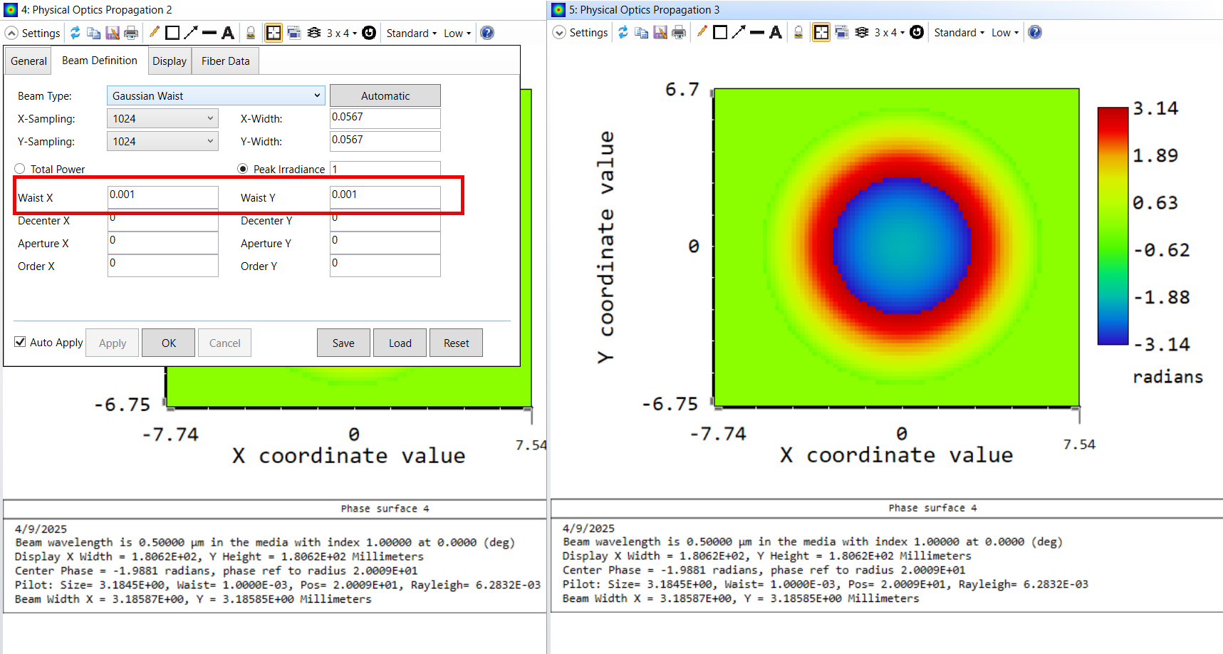

As for your question about the POP model, you're understanding of viewing the phase is correct. However, the particular file you are looking at has a very large Gaussian beam defined in POP. The Rayleigh Range is ~1.5E5 mm. Near the RR, we know that the phase front is flat, which is what you see in the viewer. Just for demonstration, I decreased the beam size so that we get sufficiently beyond the RR, and here you can start to see phase develop:
