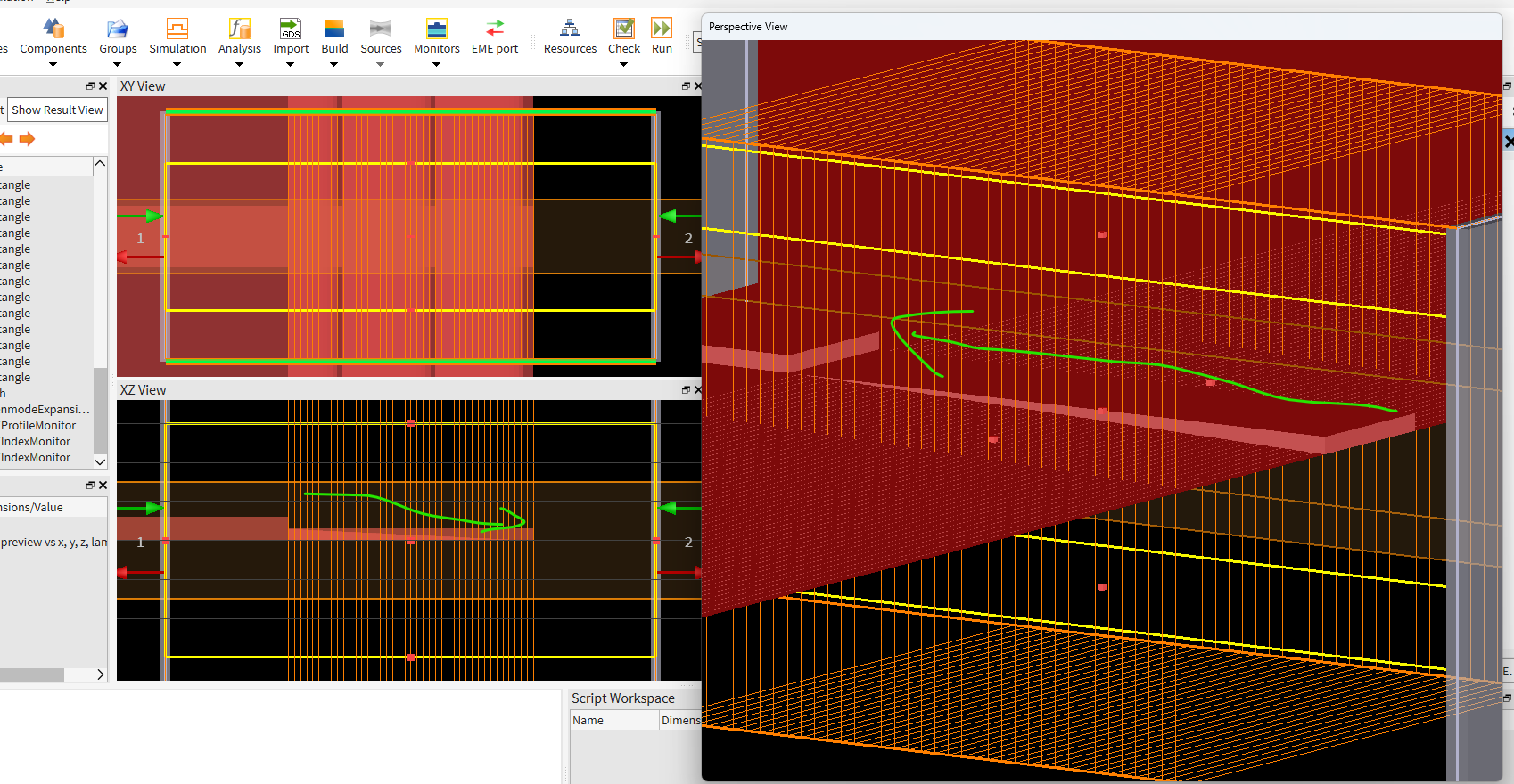

      I am reaching out to see if there were any known issues in simulating a vertical taper (not lateral taper).
      My current simulation consists of a linear vertical taper where I have a slab and rib waveguide geometry and over my tapering length the slab slowly gets etched along with the rib (rib geometry gets transferred into the slab). Once the slab is fully removed the rib geometry has taken it's place.
      Simulating this in EME I can't seem to get my results to converge at all. I have tried to do a mode convergence/cell/simulation span/mesh sweep but results seem to be very inconsistent.
      Any help regarding this would be greatly appreciated.
    • ZenerDalf
      Here is the script code used as reference. Even using Metal or PML boundaries I get full transmission of my fundamental TE mode. selectall; deleteall; clear; closeall; for (i=1:401) { name = "TFLN"+num2str(i); if (materialexists(name)) { deletematerial(name); } } n_TFLN = [2.21; 2.14; 2.21]; temp = addmaterial("Dielectric"); setmaterial(temp, "name","TFLN1"); setmaterial("TFLN1","Anisotropy",1); setmaterial("TFLN1","Refractive Index",n_TFLN); TFLN_wg_width=2.5e-6; TFLN_thick=0.6e-6; TFLN_rib_h_start=0.3e-6; TFLN_rib_h_end=0.3e-6; TFLN_slab_h_start=0.3e-6; TFLN_slab_h_end=0.0e-6; L_taper=10e-6; N1=50; l_seg=L_taper/N1; addrect; set("x min",-20e-6); set("x max",0); set("y min",-100e-6); set("y max",100e-6); set("z min",0); set("z max",TFLN_slab_h_start); set("material", "TFLN1"); set("name","Input Slab"); addrect; set("x min",-20e-6); set("x max",0); set("y min",-TFLN_wg_width/2); set("y max", TFLN_wg_width/2); set("z min",TFLN_slab_h_start); set("z max",TFLN_slab_h_start+TFLN_rib_h_start); set("material", "TFLN1"); set("name","Input Rib"); addrect; set("x min",L_taper); set("x max",L_taper+20e-6); set("y min",-TFLN_wg_width/2); set("y max", TFLN_wg_width/2); set("z min",TFLN_slab_h_end); set("z max",TFLN_rib_h_end); set("material", "TFLN1"); set("name","Output"); slab_start=TFLN_slab_h_start; slab_end=TFLN_slab_h_end; rib_h=TFLN_rib_h_start; d_slab=(slab_start-slab_end)/(N1-1); for (i=1:N1) { slab_i=slab_start-d_slab*(i-1); if (slab_i<0) { slab_i=0;} x1=l_seg*(i-1); x2=l_seg*i; #slab going to 0 addrect; set("name","Slab_taper_"+num2str(i)); set("x min",x1); #set("x min",0); set("x max",x2); set("y min",-100e-6); set("y max",100e-6); set("z min",0); set("z max",slab_i); set("material","TFLN1"); addrect; set("name","Rib_taper_"+num2str(i)); set("x min",x1); #set("x min",0); set("x max",x2); set("y min",-TFLN_wg_width/2); set("y max",TFLN_wg_width/2); set("z min",slab_i); set("z max",slab_i + rib_h); set("material","TFLN1"); } addmesh; set("x min",-10e-6); set("x max",L_taper+10e-6); set("y min",-1.5e-6); set("y max",1.5e-6); set("z min",-1.5e-6); set("z max",1.5e-6); set("dy",10e-9); set("dz",10e-9); addeme; # --- EME span --- set("x min",-5e-6); set("y min",-5e-6); set("y max",5e-6); set("z min",-5e-6); set("z max",5e-6); set("number of cell groups",3); set("group spans",[5e-6; L_taper; 5e-6]); set("cells",[1; 40; 1]); set("subcell method",[0;1;0]); set("number of modes for all cell groups",20); set("index",1.45); set("wavelength",1.55e-6); set("define y mesh by","maximum mesh step"); set("define z mesh by","maximum mesh step"); set("dy",200e-9); set("dz",200e-9); set("y min bc","METAL"); set("y max bc","METAL"); set("z min bc","METAL"); set("z max bc","METAL"); set("display cells",1); ### Setting up Port 1 ### select("EME::Ports::port_1"); set("use full simulation span",1); set("port location",'left'); set("mode selection","fundamental TE mode"); ### Setting up Port 2 ### select("EME::Ports::port_2"); set("port location",'right'); set("use full simulation span",1); set("mode selection","fundamental TE mode"); addemeprofile; set("monitor type","3D"); set("x min",-5e-6); set("x max",L_taper+5e-6); set("y min",-3e-6); set("y max",3e-6); set("z min",-3e-6); set("z max",3e-6); addemeindex; set("monitor type","3D"); set("x min",-5e-6); set("x max",L_taper+5e-6); set("y min",-3e-6); set("y max",3e-6); set("z min",-3e-6); set("z max",3e-6);

      thanks for contacting us.  Can you explain the steps you take and share a screenshot of your results where you find them not correct?
      I run your simulation and it runs OK without any issues (stack, errors). It is weird to me that the vertical taper decreases towards port 1 instead of port 2 as you can see below (green arrow)
      Also something that is wrong in your simulation is that port 2 should be on the edge of the waveguide as EME solver cannot solve any equations in free air.
      For that case you need FDTD. You should place port 2 at the edge of the waveguide and run your convergence test simulation. PLease let me know how it went
