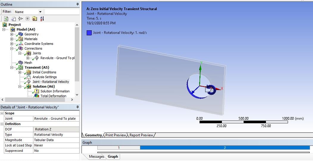

I want to verify the values of stress and deformation of rotating wheel. I implemented the model in Transient Structural Module like attached figure. The boundary condition is just only Rotational Velocity and its value is 1 rad/s. But I am not sure the way I implemented in Ansys Workbench is right.
Can you help me?
Massive thanks.

SubscriberHello Hanh,
If you want to know the stress in a flat disk due to rotational velocity, you use a Static Structural model. I know, it's counter intuitive.
Your geometry is lacking a feature to anchor it to ground such as a center hole or center shaft. That is what you would use as a fixed support instead of the revolute joint.
The problem with the revolute joint is that it is holding onto the very material you want to see expand out due to rotational velocity.
I will say that your rotational velocity is very small so the stress will be insignificant.

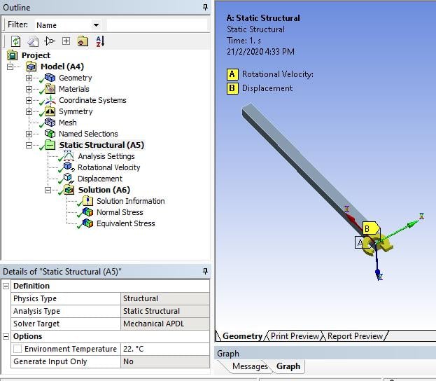

SubscriberIf you want to know the stress in a body due to rotational velocity, you use a Static Structural model with a Rotational Velocity Load. In the image above, you could use a Fixed Support on the face of the hole. What version of ANSYS are you using?

You mean that I should to use inertial Rotational Velocity Load and Fix support on the face of the hole instead of using Joint Connection and Joint Load. So, How can I see animation of the body during its moving?

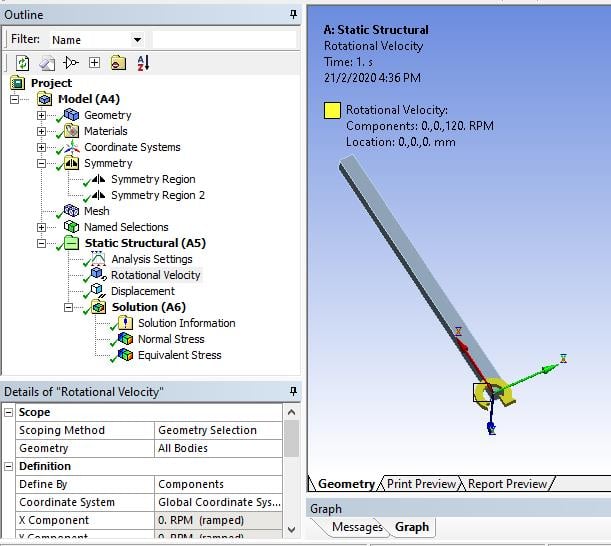

SubscriberYes, an Inertial Load of Rotational Velocity with a Fixed Support. That calculates the stress and deformation in the part due to the rotational velocity.
You don't see any animation of the body moving. Why do you need that?

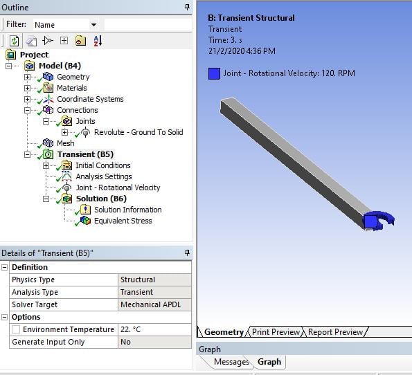

I want to determine time-varying stresses, deformations of the part and strategy of the part follow time-dependent loads. This is the reason I’d like to simulate in Transient Structure module and using joint.
Dear sir, Can I use joint connections in Static Structural module ?

SubscriberOf course for time-varying stresses, you need Transient Structural. It is always a good practice to start with a simpler model and progress to more complicated models. For example, before you run a Transient Structural model, you should run a Modal analysis to see the frequencies that are present in the structure.
Yes, you can use a Revolute Joint in Static Structural. You just add a Joint Load, where you set the Rotation Angle to 0. Then duplicate that model and change the Joint Load to Velocity. It would be best to use an equation or tabular data to ramp the velocity up from 0 to the final velocity if you are looking at start-up transient effects.
