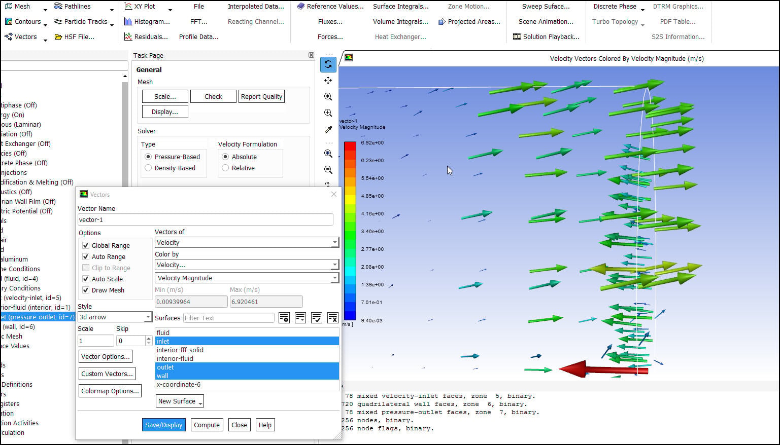

SubscriberHello, I am working on a 2d fluid flow VOF problem.
when i plot velocity magnitude at a section in console it appears as arrows both positive and negative direction(reverse flow). But when i extract the solution data and print it as ascii file, it shows all positive values. How would i find the reverse flow direction values. Kindly help.

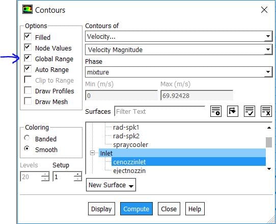

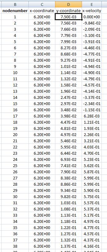

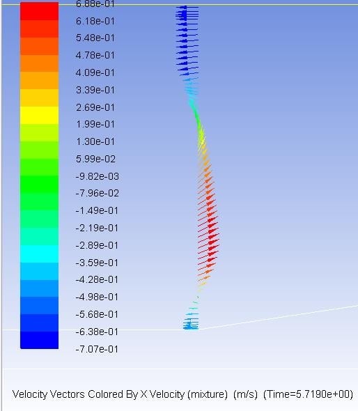

Thanks Seeta, kkanade and Kremella for your reply. I will explain my problem further.
1. figure 2 (a) shows the the console plot of x velocity showing positive and negative direction and Figure 2b shows the solution data extracted from (File->Export->Solution Data) where it show both positive and negative values
however
2. In figure 1(a) the console plot of velocity magnitude showing positive and negative direction and Figure 1(b) shows the solution data extracted from (File->Export->Solution Data) where it show only positive values.
I know Velocity SQRT(Ux^2 + Uy^2
which always gives a positive value. But I want to know its direction also when i extract them. Can you help. -

Did you try to extract the velocity components rather than the magnitude?
Regards
October 2, 2018 at 8:33 pm
prabu
Subscriberhello Raef,
Yes i have tried extracting velocity components and succeeded as shown in the last two figure.

I agree with both Keyur and Raef. You will have to export the x-magnitude and it will give you an indication of the velocity vector direction.
Velocity vector by itself has a direction, only it is being colored by the velocity magnitude. Because you are plotting a vector plot, it has both negative and positive directions (indicated by the arrows). The arrows are merely being colored by the velocity magnitude. When you are exporting the velocity magnitude data however, you are truly exporting just the magnitude and hence no direction. In the second case, you are plotting the velocity vector and are asking Fluent to color them by the x-velocity component. Since the x-velocity component resembles closely with the velocity magnitude (y and z components are really small), the vector plot in this case is very similar to the previous vector plot. Also, x-component of the velocity has a magnitude and direction and so you are seeing positive and negative values.
To summarize, vector plots always indicate the direction (because you can only use these to plot vector quantities). The legend is what is being colored by the velocity magnitude.
