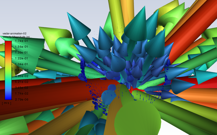

I was under the assumption that the colour of the vectors decided the "size" of them, i.e. the "amount" of velocity in the velocity vectors. But I'm running an animation and:
I've got colour descrepancies for the different vector values, but also different sized vectors - what does their differing size signify?

Vector is drawn at the center of each cell, with the length and color of the arrows representing the velocity magnitude.

SubscriberAh OK, I assumed only the colour represented the magnitude of the vector, not the size as well. Thank you!

I couldn’t access the tutorial without the Ansys licence number (trying to source that off the college) – for anyone browsing in the future, I’ve figured out that the colour is the magnitude, while the size is the magnitude relative to the other arrows. So if there’s a large differrence between max and min, the size of max will be much larger than the minimum arrows.
