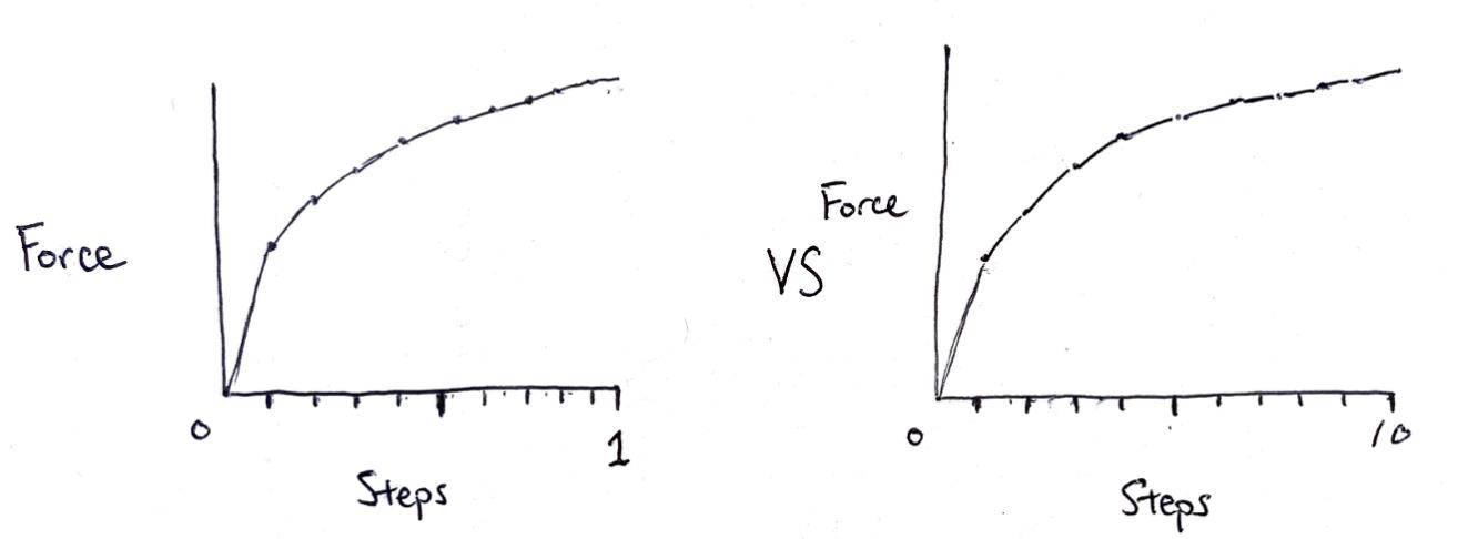

      In transient structural, what is the difference between applying a load that varies in its magnitude over 1 step vs multiple time steps (like 10 steps, for example)? Which method is considered more conventional? Please see the picture below for your reference. Both represent a simulation of 1 second.
      Also, I will be coupling this transient structural with fluid flow (Fluent). Would the "1 step method" or "multiple steps method" affect convergence during coupling?

      It is easier to have 1 step and let the substeps define the intermediate points.
      One reason to have 10 steps is if you need data at exactly 1 second increments, and the automatic substeps might not land on an exact integer time.

      Can you please elaborate on what becomes "easier"?
      If I chose to do the 1 second simulation with varying load over 1 step (10 increments like the photo),
      • Is 10 the appropriate Number of Substeps?
      • Would the simulation be affected in any way if I chose 100 substeps?
      • What should the Step Size be in Fluent/System Coupling?
      Again, thank you so much for your help.
      Edit: Ideally I want 100 "pictures" or data over 1 second (so, "pictures" at every 0.01s).
      If you have 10 steps, the Analysis Settings for each step have to be done one at a time, which is one reason one step is easier.
      If you want 100 pictures, then just set the Initial and Minimum Substeps to 100.  The Maximum substeps can be 200.
      There is no penalty in using 100, it just makes the solution take more time to finish because more data has to be computed and written.

      Ok, so if I was to get 100 "pictures" or data using 100 substeps, is it correct to have 0.01s for my Step Size and End Time of 1s in System Coupling?
      Thank you for being patient with my questions!
      Yes, that is correct if both systems can converge with that time step.
      You might need smaller time steps so that each system can converge.
