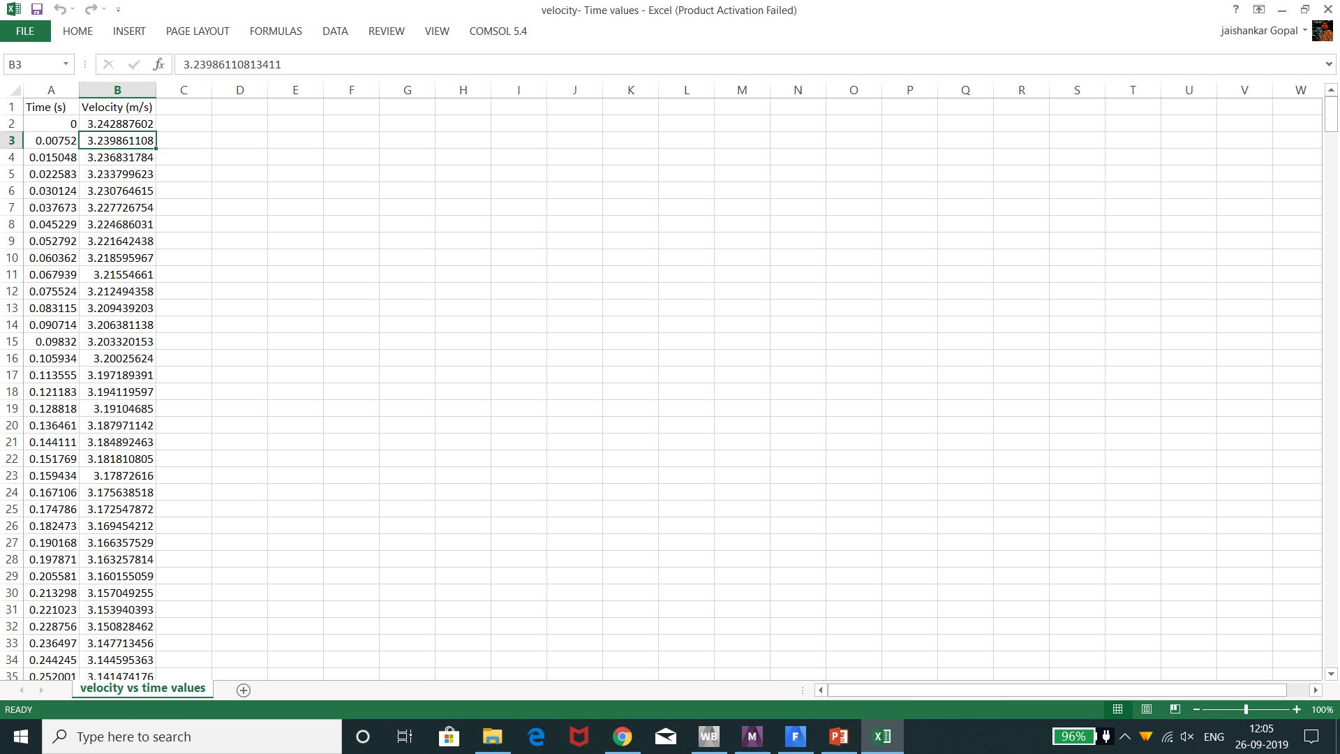

This is Jaishankar, I am working on a problem where molten aluminium flows through the pipe. In this case the velocity varies with respect to time. I have modeled and found the velocity vs time values in excel. I dont know how to import this in my problem.
Please let me know how to give a variable velocity inlet

Forum ModeratorAssuming you mean a transient inlet velocity (ie changing with time) have a look for the section on profiles in the Fluent User's Guide.Â
