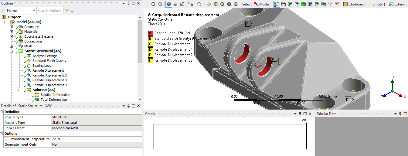

SubscriberHello, I have performed a static structure simulation with the following configuration

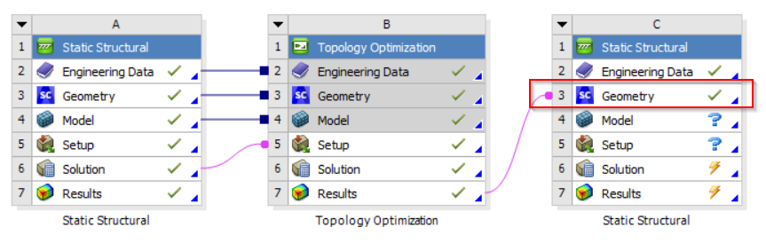

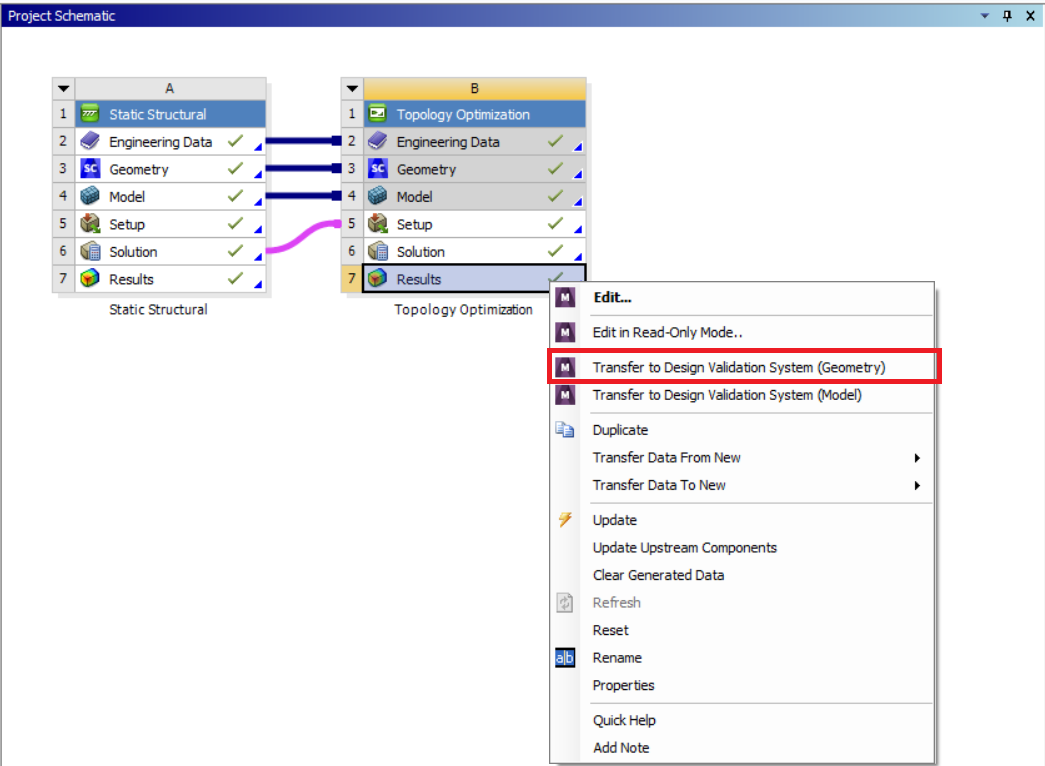

Once the geometry is topologically optimized, the cylindrical surface where the bearing load is applied changes and thus you need to repair the topologically optimized geometry. On the repaired cylindrical surface the bearing load will be applicable.
To repair geometry, use "Transfer to Design Validation System (Geometry)", as shown below -
