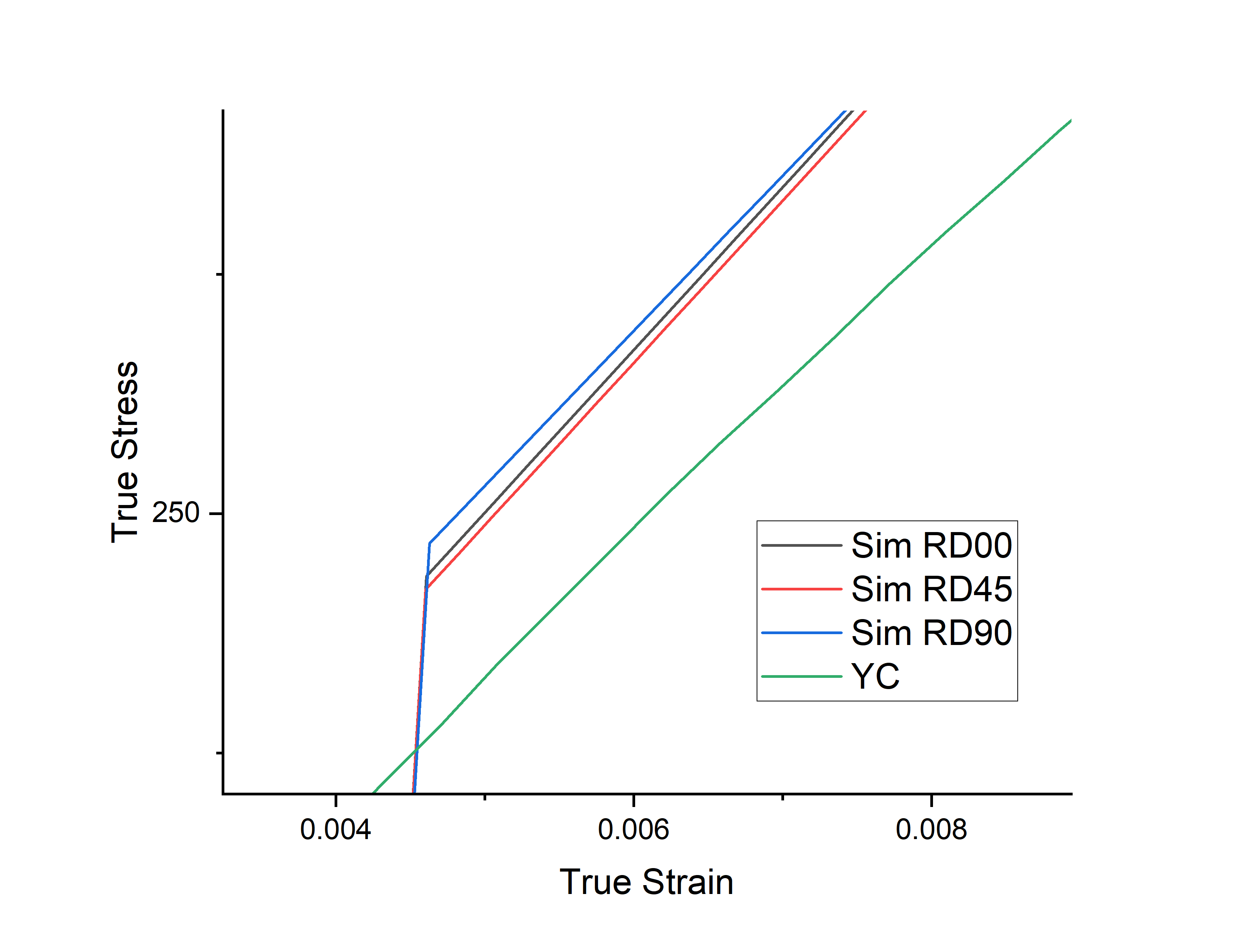

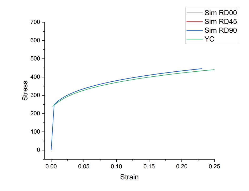

I would like to know how we could validate a simple one-element test and a tensile test. I have now generated everything, but I am a bit confused, as my stress-strain curve are all the same with the 3 Rolling direction (0, 45 and 90), the difference is small at a scale of 0.1-0.01. THe material model im using is the MAT133 Barlat Yield 2000-2d.Â

Ansys EmployeeHi Tarek, Do you have any pictures comparing the stress-strain curves of the one-element model versus the experimental data in all three directions? Please remember that the comparison between the one-element model and the experiment is only valid up to the onset of necking in the actual tensile test. -

Ansys EmployeeThank you. Assuming that RD is your reference direction, it should yield the same response as the input hardening curve. Here are a few suggestions:
Try running the *MAT_133 with all the Barlat anisotropic coefficients (ALPHAi) set to 1 and the exponent (A) set to 2. This verificiation step will essentially simplify the model to isotropic von Mises, and it should provide identical stress-strain results in different directions, all matching the input hardening curve.
Once the step above is verified, implement the anisotropy coefficients that you calibrated using experimental data.
Ensure that the material axes are selected properly (AOPT variable) to indicate that the single-element test is pulled in the RD. Compare your RD results with the input hardening curve.
