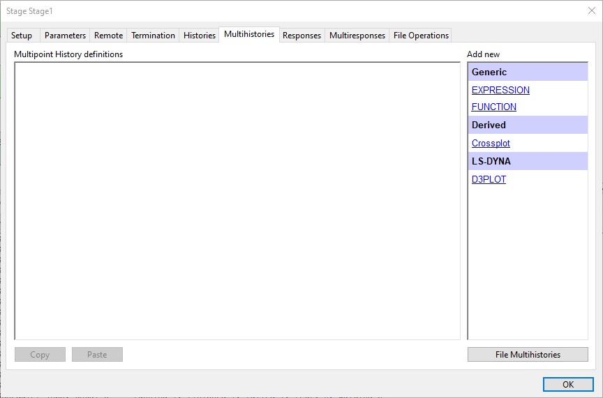

SubscriberWe're going to use abaqus to check a plate that's been subjected to a load. The material properties are to consist of a variety of parameters. We heard we could do this using LS-opt. However, we dont want the model to be optimized. We need the results (forece displacement stress-strain) for each type of material. Does someone know if it is possible and how we can to this?

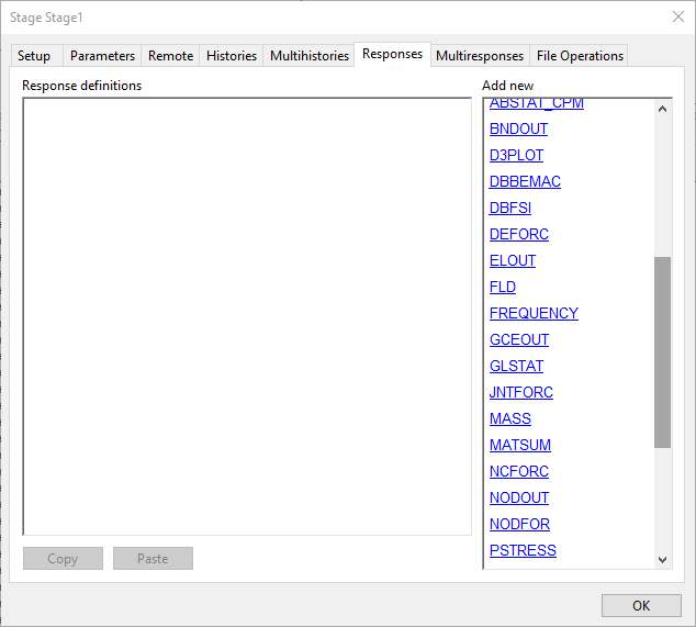

Ansys Employeecheck the responses for the selected solver,
then from these responses from ABACUS solver, find the response which can output the forces (SPCFORC in dyna) displacement and relevent stress and stain output for an element and then define a crossplot from Multihistories
from here, its a direct, this will be written out in the solver directory.

For extracting stress-strain curves, you have a few options. a. If abaqus can write the curves to a file in two column format, copy this file as "LsoptHistory" and read it in LS-OPT using "user-defined" history option. For example, say abaqus dumps a file stress.txt with two coloumns of data (stress vs time), you can go to "histories" tab and define "user-defined" history. The command in Linux will be: cp stress.txt ./LsoptHistory; cat LsoptHistory (or) b. Use GenEx tool in ls-opt to extract columns of data from ascii files. You will have one history for stress, one for strain, then use "crossplot" to create stress vs. strain. The experimental data can be imported using "File history" option (located bottom right in "history" tab).
