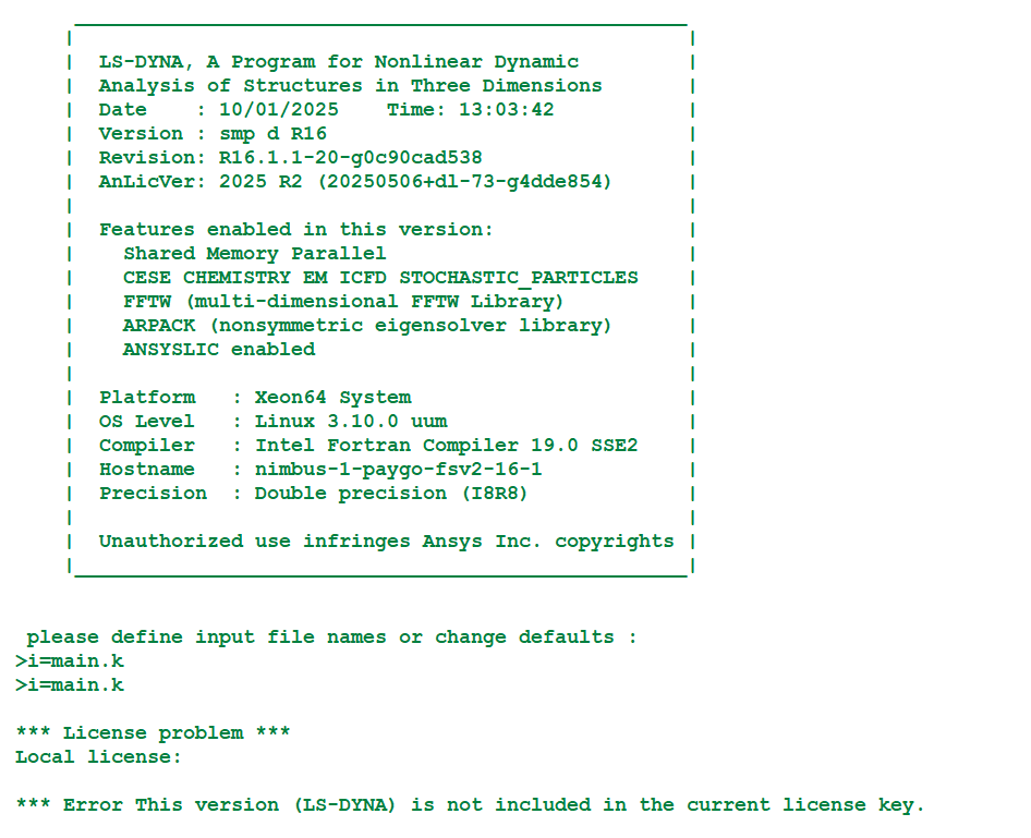

Just to make sure - are you using Workbench (25R2 runs 14.1 I think by default so how do you run 16.1 - also whcih Uni are these licences from?)
For the error - try please to set the enviromental variable called LSTC_LICENSE -> to Ansys.
All the best
Erik -
March 30, 2026 at 4:19 pm
roberto.scipioni
SubscriberThanks.

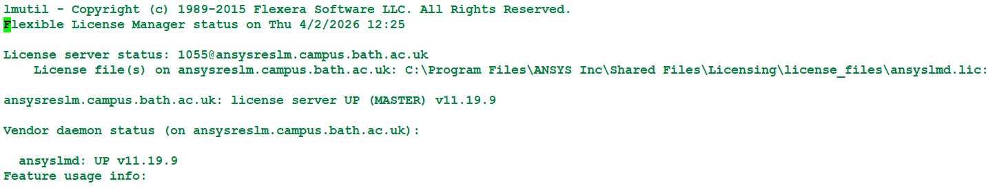

1) University of Bath, UK
2) LSdyna 16.1.1 was downloaded separately
3) Using Ansys2025R2
I am using
export LSTC_LICENSE_FILE=network
export LSTC_LICENSE_SERVER=1055@ansyslm.campus.bath.ac.uk
export LSTC_LICENSE=ansys

Since using ANSYS SLM we need to use these two only:
export ANSYSLMD_LICENSE_FILE=1055@ansyslm.campus.bath.ac.uk

Ansys EmployeeSo, you can run the default solver (14.1) without any issues? I recall a case where a similar thing happened, and it was resolved by upgrading the license manager to 2026R1 version!

SubscriberYes 14.1 is fine with Ansys2024R2 and Ansys2025R2 however, in using LSDyna 16.1.1 it complaints that the version is not include in the license
April 13, 2026 at 6:45 pm
Nanda
Ansys EmployeePlease try upgrading your license manager to 2026R1, or your whole Ansys package to 2026R1. 2026R1 has R16.1 solver by default!

So, we have 2 types of LS-DYNA licenes. The LSTC one and Ansys one. I only handle LSTC type and I can show you where it's written if you're using LSTC LS-DYNA licenes. Since, you're not using LSTC licences, I'm really not sure what happens on the backend of Ansys LS-DYNA Flexnet licenses. Me, Erik, and other employees who contribute here are only product guys, we are not familiar with Ansys license related queries.

You see the REVISION 6, REVISION 7 part, they restrict which solvers can be used. As an example, if you have a license file with REVISION 15, you can't use any solvers with IDs greater than 15, like R16 or R17. You would ideally get this error:
I hope this clarifies things on LSTC license. Now, if you're using LSTC licenses inside Workbench, this error might not be exposed clearly. That's why you receive a more generic error.
