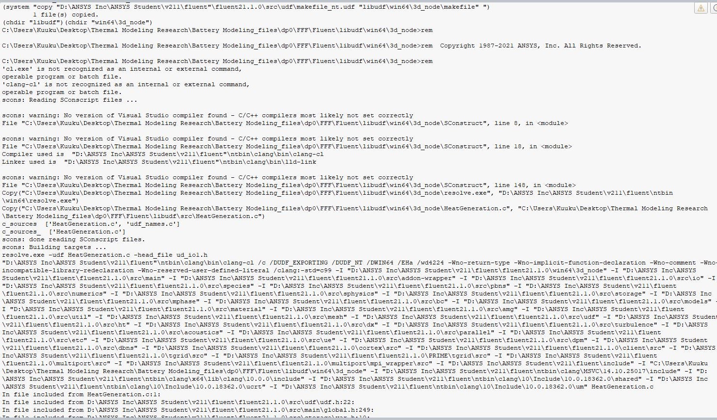

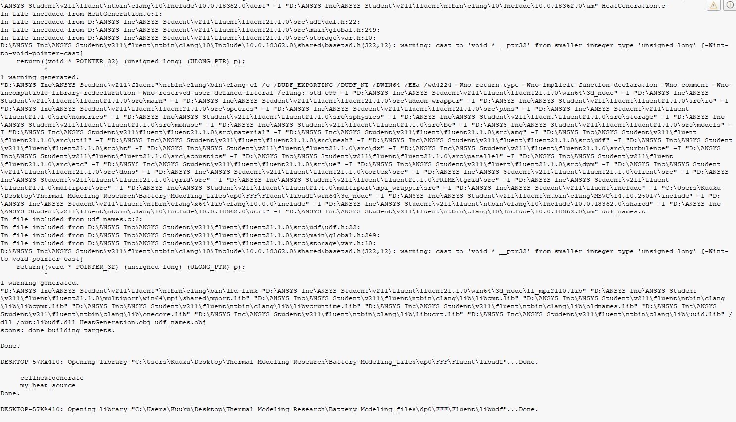

SubscriberI'm currently attempting to use the following UDF I found off the CFD-Online forum.
#include "udf.h" #include "math.h" DEFINE_ADJUST(cellheatgenerate,d) { real SOC,ds,tm,Ri,tempu,volume,source,temp; Thread *t; cell_t c; tm = CURRENT_TIME; thread_loop_c(t,d) { begin_c_loop(c,t) { SOC = 1.-((90.*tm)/5400.); if ((SOC >= 0.) && (SOC <= 0.77)) ds = (99.88*SOC)-76.67; else if ((SOC > 0.77) && (SOC <= 0.87)) ds = -30.; else if ((SOC >0.87) && (SOC <=1.)) ds = -20.; volume = C_VOLUME(c,t); tempu = C_T(c,t); if (tm == 0.) temp = 291.15; else if (tm > 0.) temp = tempu; if (temp <= 298.15) Ri = 0.000002258*pow(SOC,-0.3952); else if ((temp > 298.15) && (temp <= 308.15)) Ri = 0.000001857*pow(SOC,-0.2787); else if (temp > 308.15) Ri = 0.000001659*pow(SOC,-0.1692); temp = C_T(c,t); source = ((Ri*8100.)-(90.*temp*ds/96.485))/volume; C_UDMI(c,t,0) = source; } end_c_loop(c,t) } } DEFINE_SOURCE(my_heat_source,c,t,dS,eqn) { real source; source = C_UDMI(c,t,0); dS[eqn] = 0.0; return source; }I'm currently having problems applying this UDF to my Fluent simulation. I open up Compiled Functions, add the .C file, build it, then load it without any errors showing up, but I'm unable to see where the myheatsource and cellheatgenerate is being applied.
June 21, 2021 at 12:13 pmKarthik Remella
AdministratorHello Can you post a screenshot of the output printed to the Fluent Console when you compile and load the UDF?

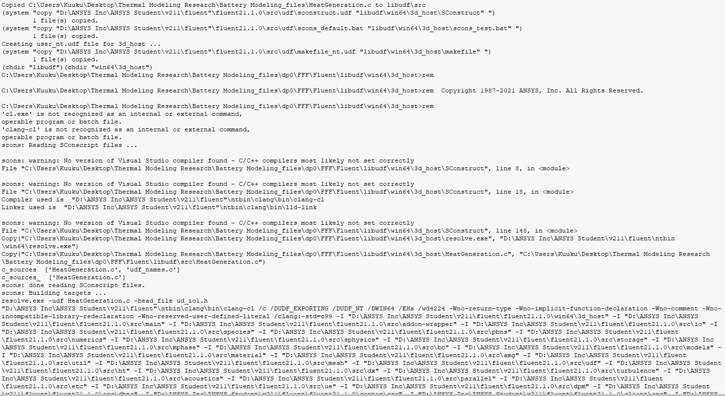

June 21, 2021 at 9:15 pmkuuku.botchway
SubscriberAttached is the output from the console
June 21, 2021 at 9:16 pmkuuku.botchway
SubscriberAttached is the text log as well

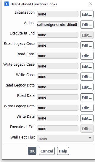

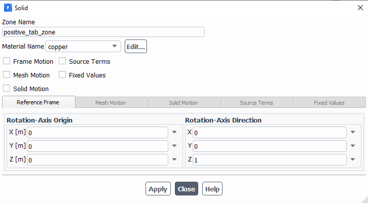

June 22, 2021 at 9:09 pmJune 22, 2021 at 9:17 pmKarthik Remella
AdministratorHello Did you hook your adjust function? Also, you should see this volumetric source under cell-zones? What do you see under 'Cell-zones' when you activate 'Sources'?
Karthik
June 23, 2021 at 12:27 amJune 23, 2021 at 10:59 amKarthik Remella
AdministratorCheck the Source term check-box. Under the Source Term tab, add a source for Energy and see if the other function 'my_heat_source' shows up there.

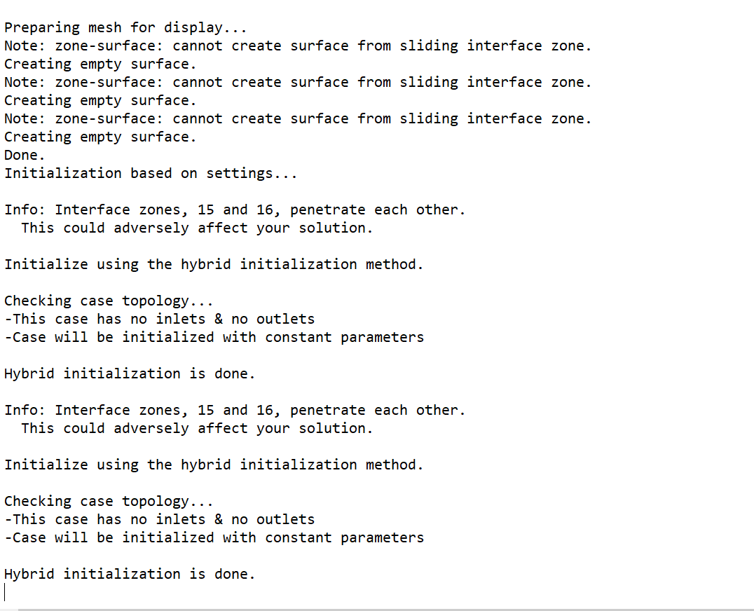

June 24, 2021 at 3:54 pmkuuku.botchway
SubscriberSo I seem to have ran into another problem with this UDF. Everytime I attempt to run it Fluent seems to crash, I have setup the hook function and set the Source terms for each Solid I want the source to attach to.
this is what I'm getting when I initialize the function. Then when I run the calculation it crashes.
June 24, 2021 at 4:11 pmRob
Forum ModeratorI'd start by checking the two interface zones.
June 26, 2021 at 4:48 pmJune 29, 2021 at 7:22 pmKarthik Remella
AdministratorI'd recommend that you start writing a transcript file before you run your simulation. This will write out an output file and will help you identify the issue.
