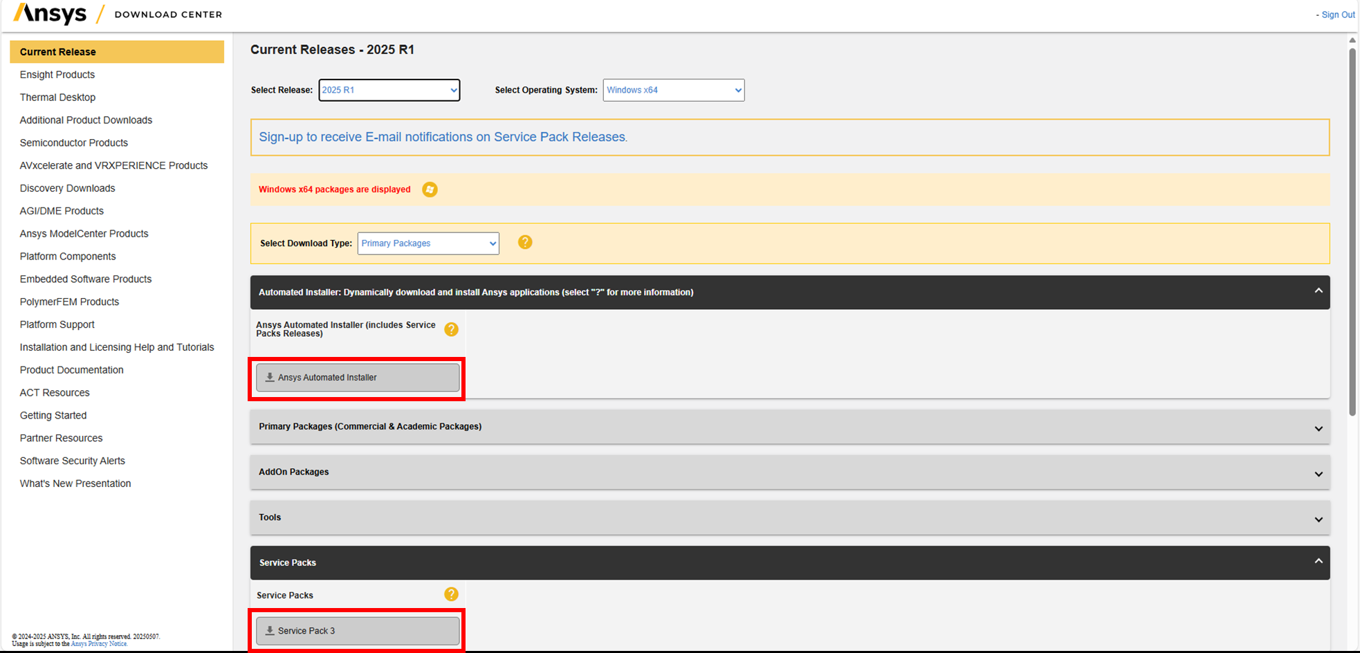

      How to install a Service Pack for Workbench/Mechanical?
      You can install a Service Pack (SP) for Workbench using either the Automated Installer or standalone executable files. To access these, sign in to Ansys Customer Portal and go to the Download Center. Select the release of interest. Then, download the automated installer or standalone Service Pack installation files. E.g.:
      If you are using the installer, run the downloaded executable "as administrator" and follow the steps provided in the installation wizard. Select the desired SP level in the corresponding screen. E.g.:
      If you are using the standalone SP installation files, un-archive the files after downloading, then run the executable "as administrator" and follow the instructions in the installation wizard.
