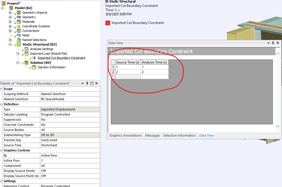

      Essentially, I am trying to automate the creation and definition of a Cut Boundary Constraint for a submodel.  This is using the ironPython in the console embedded in Mechanical.  With the Macro Recorder I have figured most of it out.  However, I cannot figure out how to access this worksheet that comes for specifying the "Source TIme" property.   Neither the Ansys.ACT.Automation.Mechanical.ImportedLoads.ImportedLoadGroup object, or Ansys.ACT.Automation.Mechanical.ImportedLoads.ImportedDisplacement object, have an input/output property that I am used to filling our tabular loads.
      Can anyone assist?  Here is what I have so far:

      table = icut.GetTableByName("Data View")
      #table.Columns    # lists column header names, which are row dictionary keys
      row1 = table.Item[0]
      #row1.Item is dictionary with keys as shown from table.Columns
      # table changes will not be seen in the table unless click away and on imported load again, or use ExtAPI.DataModel.Tree.Refresh()
      row1.Item['Source Time'] = 1    Setting to zero will set to 'End Time' when using internal transferred loads (Not External Data system)
      row1.Item['Analysis Time'] = 1.2

    • mscal
      It works, thank you.  Is this method/property GetTableByName, and the resulting interface to the table, documented anywhere?
