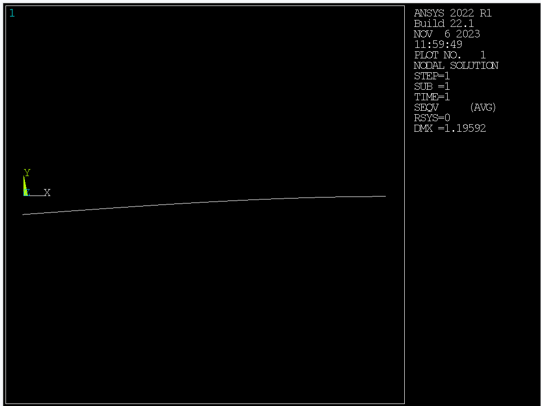

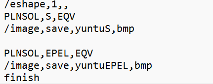

SubscriberIn matlab, I use statements like this "s1="E:ANSYS2022ANSYSv221ansysbinwinx64ANSYS221.exe -b -i C:UsersLYDesktoptesttxt write to override experimenttest01 (test).txt -o C:UsersLYDesktoptesttxt to write override experiment"; "to call ansys and execute the command stream I've written.Now I hope that in this way I can save the calculated stress contour diagram, I don't know if this way is possible, I hope you can help me achieve this requirement. I've used a statement like this in the picture in the command flow, but I can't save the stress contour diagram. However, I opened ansys APDL and imported the written command stream (.txt) text, which saved the stress contours

November 6, 2023 at 4:19 am
November 6, 2023 at 3:26 pm
mrife
Ansys EmployeeLooks like the /eshape,1 is missing

SubscriberThe command I used was:
/eshape,1,,/show,pngplnsol,s,eqv/show
I used the /eshape,1 command, and now I'm confused -

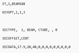

SubscriberThank you, this way I open Mecheanical APDL Product Launcher, and then read the file I wrote in advance (.dat) can meet the requirements. But I use matlab invoking ansys (" s1 = "E: ANSYS2022ANSYSv221ansysbinwinx64ANSYS221. Exe - b - C: I UsersLYDesktoptesttxt write to override experimenttest01 (test).txt -o C:UsersLYDesktoptesttxt to write override experiment";) There are still problems. As you can see from the result file, the program will stop at this step (plnsol,s,eqv), and eventually the program will stop running. I wonder if there is something wrong with my ansys setup?
