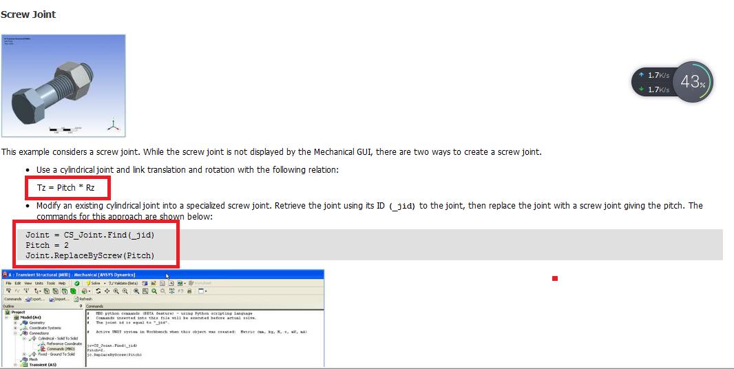

Use a cylindrical joint and link translation and rotation
    • wb982506188
      About the cylindrical joint
      I do not understand the setting of the srew joint , so I need some help?
    • Sandeep Medikonda
      What don't you understand? Please explain in more detail.
      Refer to the help and see this video:
      https://www.youtube.com/watch?v=kkYLar2etDg
    • wb982506188
      I do not understand the skills in the above picture and I can not find the related video about the screw joint.
