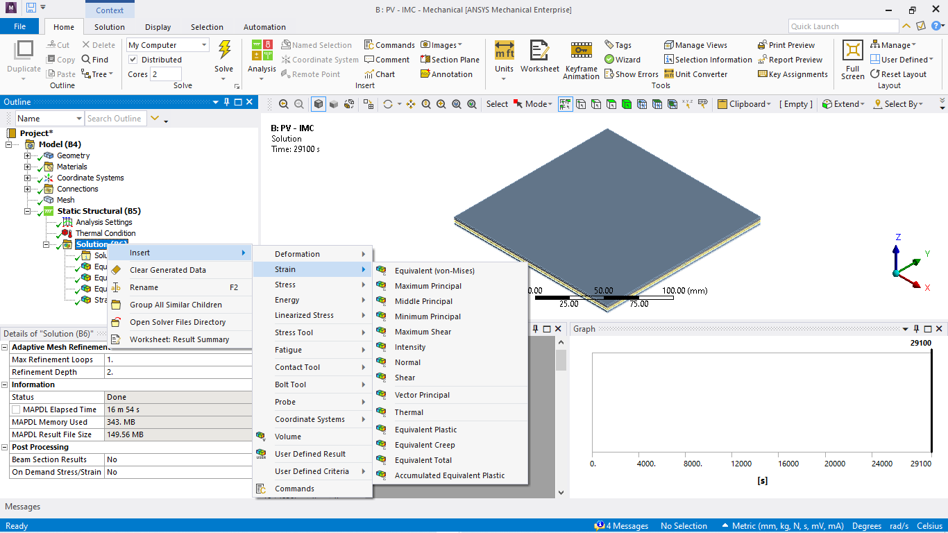

I want to know how to evaluate the accumulated creep strain results from my static-structural simulation of a photovoltaic module.
I have carried out the simulation and one of the results I have obtained is the equivalent creep strain distribution.
However, there is no option for showing the accumulated creep strain distribution.
I have attached the screenshot of the simulation.
Any help in this will be highly appreciated as I need it for my project work.

Finally, there is no option as far as I can see to plot or obtain accumulated creep strain, only plastic strain.
