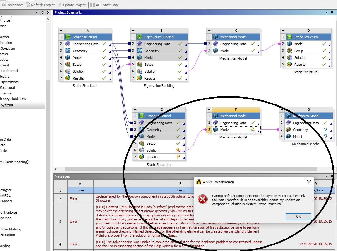

      I was wondering whether anyone has worked with the UPGEOM command, I am using it after buckling analysis, to create a perturbed geometry for nonlinear post buckling analysis. I was wondering if there is a way to visualize the new created geometry after the UPGEOM command?

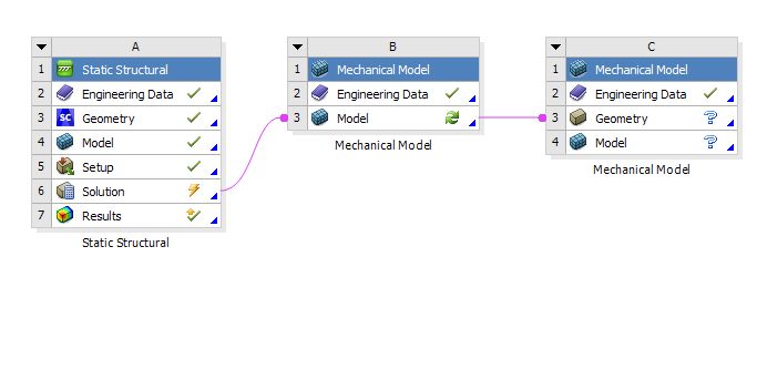

      Which version are you using? You can connect the solution cell of the analysis where you have the deformed model to Model cell of the Mechanical model and in turn connect it to Geometry to get the geometry.

      yes , but I want to see the geometry because I am having a trouble with the solution converging due to the mesh so i would like to see the geometry amd the mesh.
