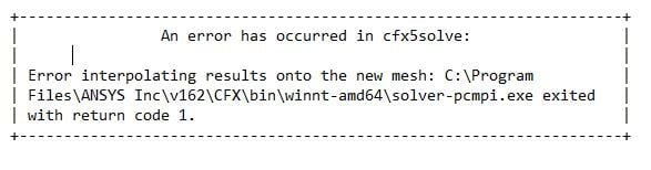

Update failed for the Solution component in CFX. The solver failed with a non-zero exit code of : 2
    • Dima
      Hello everyone,
      I am beginer user with CFX. Could you please help me with error of CFX: Update failed for the Solution component in CFX. The solver failed with a non-zero exit code of : 2. This error hapened when i started rted Solution.
      I did not  find anytthik about this error in the internet.
      Please, help me or tell me where i can find something about this type of error. Thank-you

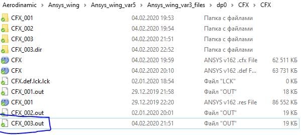

    • DrAmine
      What does the CFX outfile tell u?
    • Dima
      Where i can see this file?
    • DrAmine
      In the file directory of you workbench directory.
    • Dima
      Is this file -  output file?
    • DrAmine
      yeah check there at the end of that file for the error message.
    • Dima
      If i am right, the problem  with mesh?
      Below i put all information from outfile. What can be the problem?
      Thanks.

       Details of error:-
       Error detected by routine MAKDAT
       Illegal data area length CDANAM =  NCOMPT CDTYPE =  INTR ISIZE =  0
       CRESLT = SIZE
       Current Directory : /INTERP/SOLUTION/DST/VX
       |                   ****** PROBLEM REPORT ******                     |
       | Subsystem: Input and Output                                        |
       | Subroutine name: ErrAction                                         |
       | Severity level: Fatal Error                                        |
       | Error message number: 001100279                                    |
       | Message:                                                           |
       | Stopped in routine MEMERR                                          |
       |                An error has occurred in cfx5solve:                 |
       | Error interpolating results onto the new mesh: C:Program          |
       | FilesANSYS Incv162CFXbinwinnt-amd64solver-pcmpi.exe exited   |
       | with return code 1.                                                |
       | The following user files have been saved in the directory          |
       | DMEGA/Mega/Education/PhD/Model/Aerodinamic/Ansys_wing/Ansys_win- |
       | g_var5/Ansys_wing_var3_pending/dp0_CFX_Solution/CFX_003:           |
       | job                                                                |
       | For CFX runs launched from Workbench, the final locations of       |
       | directories and files generated may differ from those shown.       |
       |                              Warning!                              |
       | After waiting for 60 seconds, 1 solver manager process(es) appear  |
       | not to have noticed that this run has ended.  You may get errors   |
       | removing some files if they are still open in the solver manager.  |
      This run of the ANSYS CFX Solver has finished.
