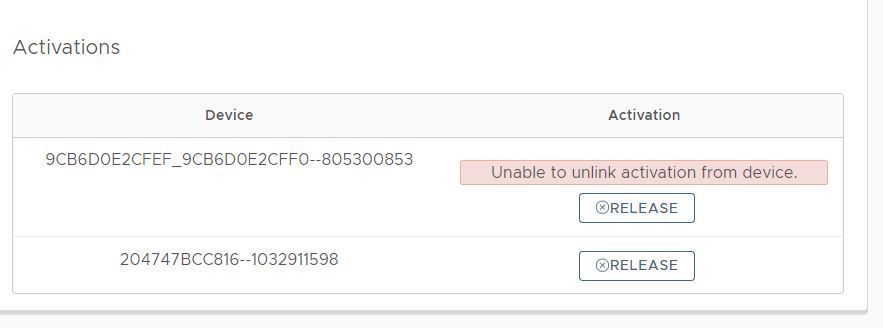

SubscriberI am trying to release one of mine license activation of Discovery from Ansys account. Successfully entered my Ansys account but when I want to release one of the activation a message is shown:Â Unable to unlink activation from device.
What should I do?

SubscriberAlso getting this issue with a few customers. We have tried manual release which comes up as a success. However has no effect . Going back into the subscriptions tab shows the license activated to both ID's
The license can't be un-assigned from the administration tab as you also get the same error of 'unable to unlink'.
Is there something wrong with the servers or any other way of releasing as number of customers having license issues.

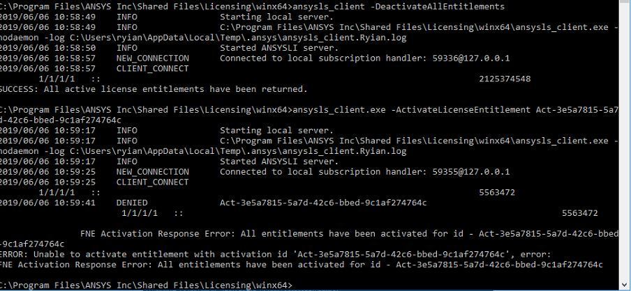

Meanwhile, when I reproduced this issue, I deactivated the entitlements from command prompt. The command executed successfully. I then refreshed my Discovery account page and all activations were released successfully. Can you try this manual deactivation again at your end?

tim.dukes
SubscriberHi Naresh
I will ask the customer for this.Â
However the issue isn't with re-activation the issue is with releasing the licenses. In the above image we can see that it says success but it actually doesn't release the licenses and we also can't do this via the portal. So the issue is with releasing the activation not re-activating.

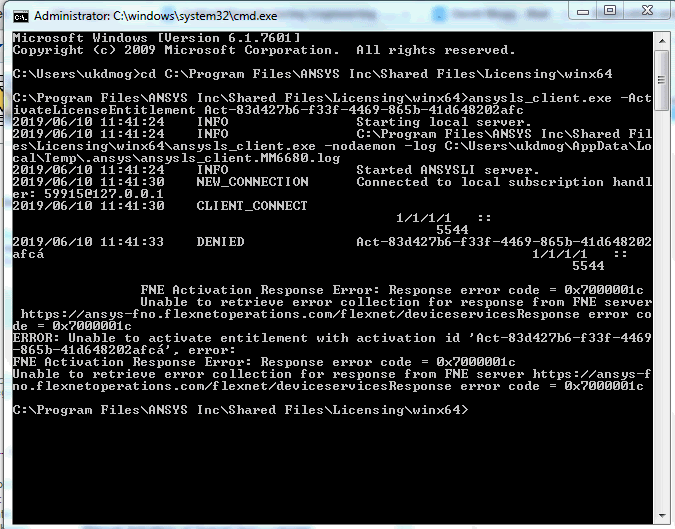

While the licensing team is working to fix the server side issue, please advice the customers to deactivate the subscription from command prompt and then activate it on required machine using activation command. It has been confirmed that this manual deactivation and activation is working fine. The commands for deactivating and activating are mentioned in the below forum post:

Ansys EmployeeHello Tim Dukes
I am not sure but I suspect it could be associated with the server issue that is being faced. Can we get the ansysls_client.log file from %temp%.ansys folder and the UTC time when this error occurred?

Ansys EmployeeHello Tim Dukes Josef Mrtka FBR
The server issue has been fixed and the activations can be released from the account page. Please let me know if you still see any issues.
