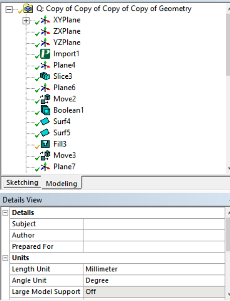

SubscriberHi my imported geometry unit says milimeter on length unit in the design modeler. In mesh it says meter and i cannot change after i solve the question in cfd post the mm bar under the screen looks wrong. How can i change this. Is it has to be set up on polyflow or somewhere else. In polyflow mesh info menu it says length unit meter.
May 24, 2021 at 11:30 pmSurya Deb
Ansys EmployeeHello,
Can you try changing the units in CFD Post from Edit-->Options-->Units?
You should be then able to select the desired unit for display.
Regards SD
